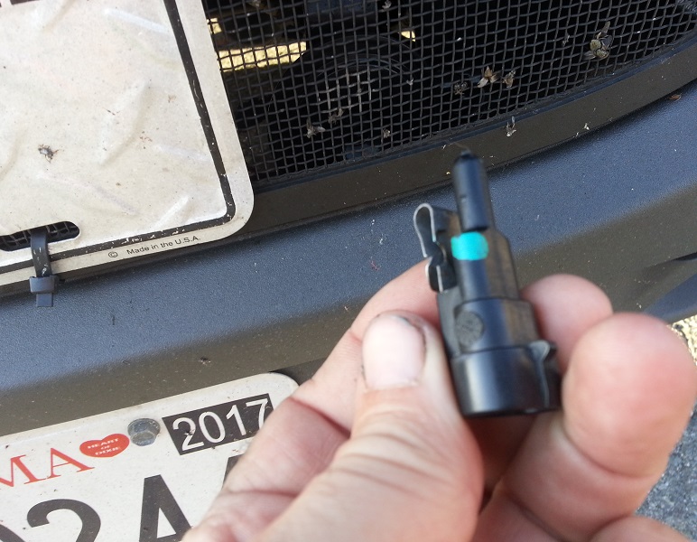

    Sometimes you just need your Prostar to Idle, but it's set to cut off after 5-30 mins. My truck had a load shedding issue and our main terminal breakdown department explained how to bypass this feature short term until I could get it into a terminal to be repaired. To bypass, they said to unplug the ambient air temperature sensor and it will continue to idle until you shut it off.
    1 shut truck off
    2 Find the sensor. 2014 and newer it is behind the mesh grill in front license plate area clipped to the city horn bracket. In the photos it's clipped where the green dot is.
    on 2013 and older, it's clipped to the drivers side frame rail in catwalk area. Red circle shows the sensor dangling. I unplugged mine and keep it in the truck.
    3 unplug the sensor and start truck. Happy Idling
    NOTE--It will set a check engine light while unplugged and depending on your companies policy, this could get you in hot water for tampering with their truck. To turn off the check engine light, Plug sensor back in with key off and start engine... voila, check engine light turns back off.
