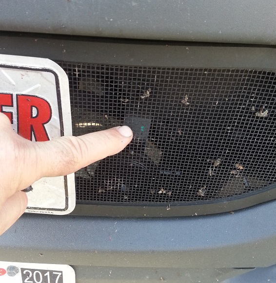

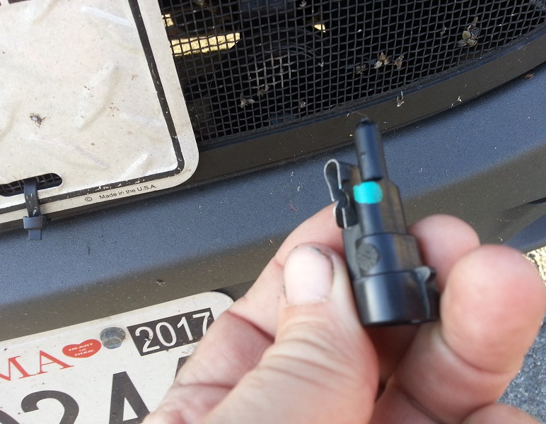

    I unplugged the temp sensor for the 2012 international 4000 to test the idle shut down...result is it has no effect on the 5 min idle shut down
