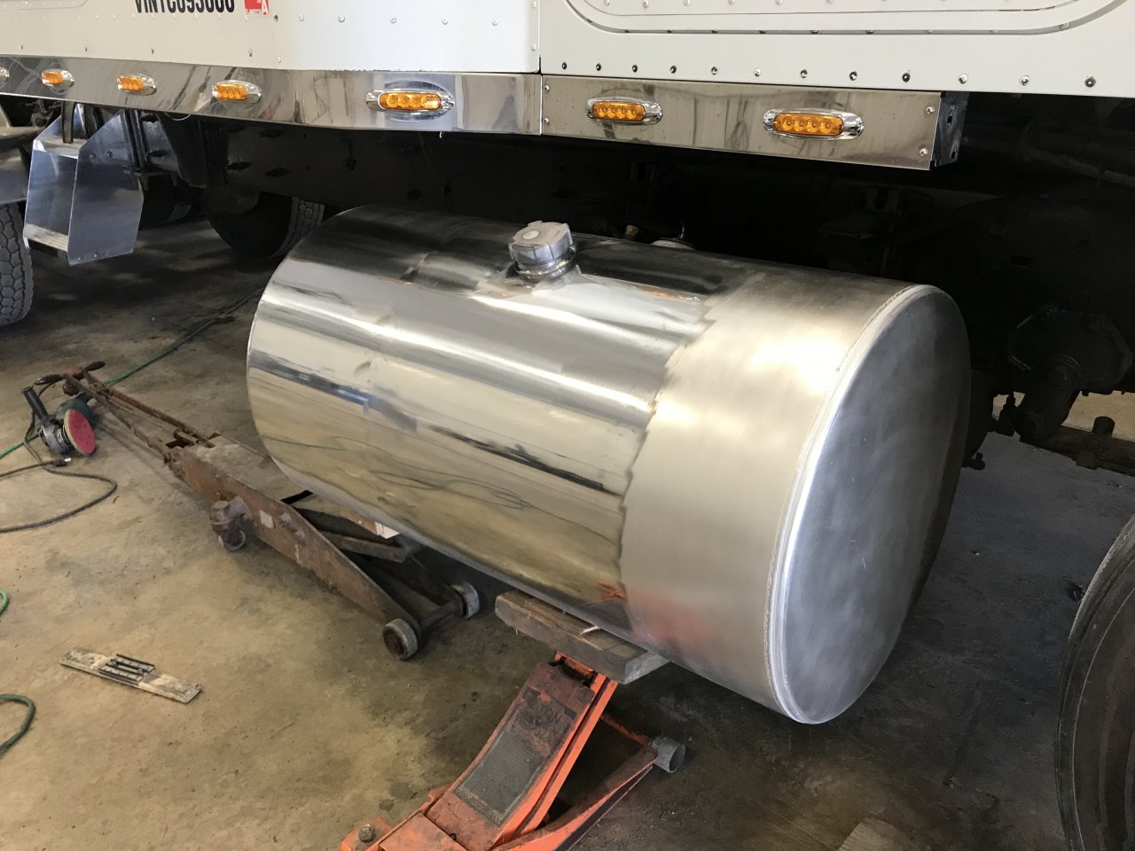

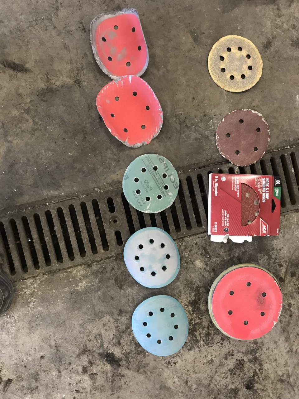

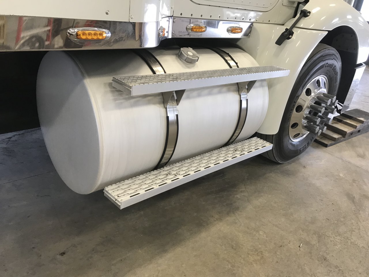

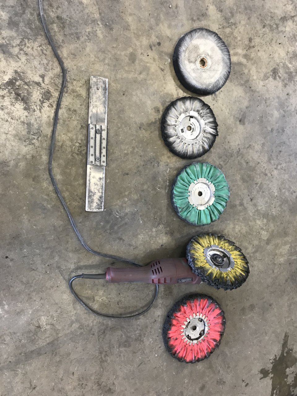

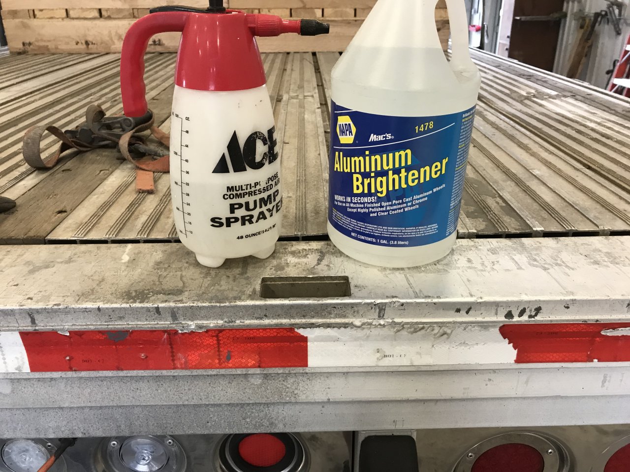

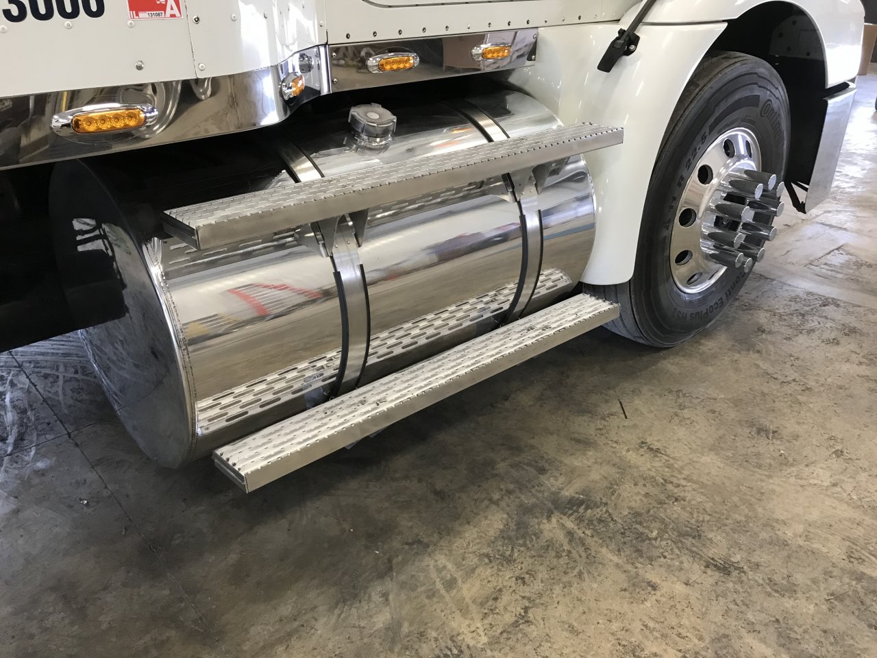

    My best advice is keep up on it and you won’t ever need this........ E82D38FC-5D23-4C4F-9048-868C9A9AD3A5.jpeg B9BB3440-88D2-490C-AECF-73C3AB3F07C4.jpeg 1DBF3F21-0514-4D7C-9035-892500B45489.jpeg to do this....... 1D5F30C7-4525-4EF1-B512-9A060E29E848.jpeg 83D75BC5-6D15-476A-BA0F-DA0A075000E0.jpeg ED5728BB-8EB2-4529-A618-EC628A435066.jpeg it took a full day just to do each 100 gallon tank because they had been so neglected over the last 17 years.

  3. 1nicevette

    KB3MMX and Tug Toy Thank this.

    Color me impressed.

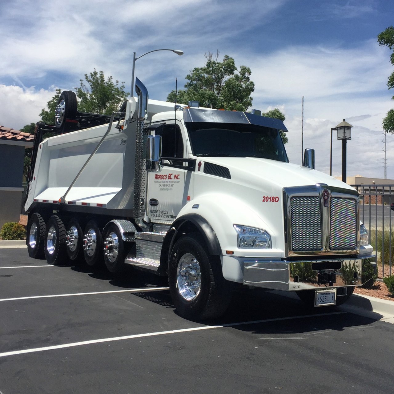

    ABAA04D3-6748-4848-9481-F9D670610619.jpeg I polish my wheels every week. A fast rack every week keeps em lookin good. Tanks and steps and the hard stuff about every 3 months or so. I use rebel red for most hand polish jobs. And zephyr products for machine
