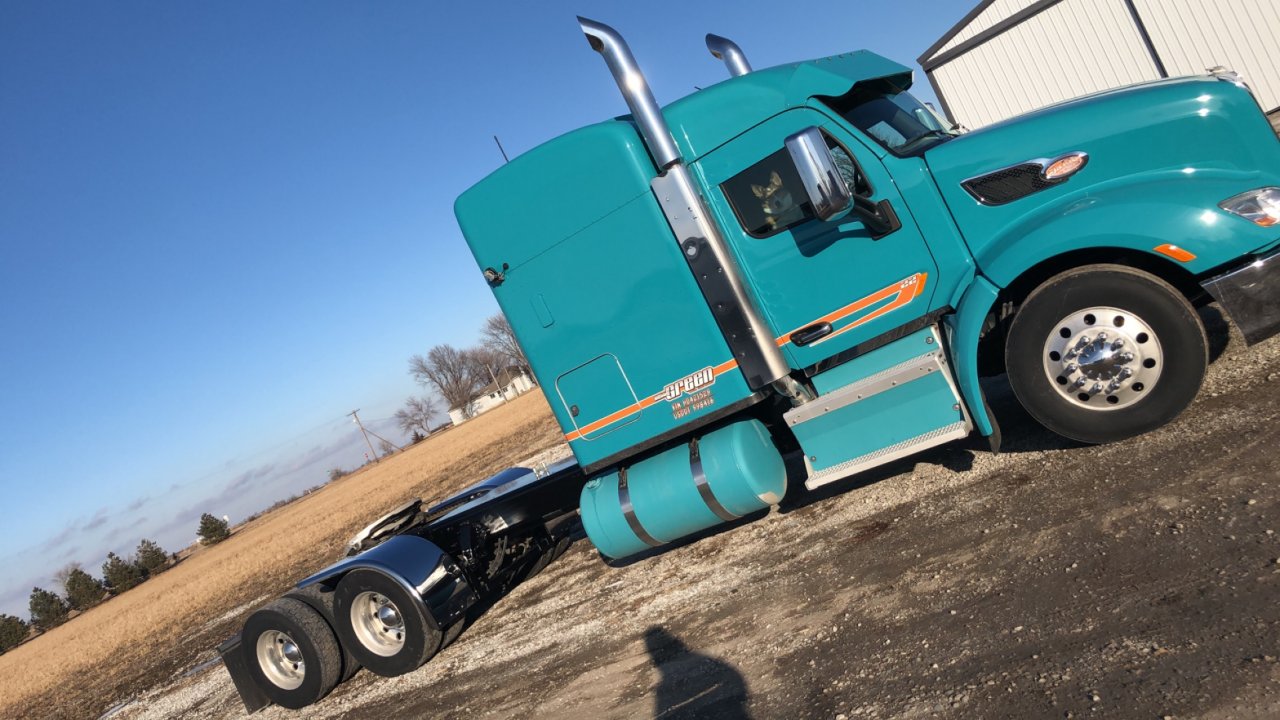

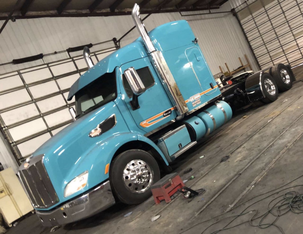

    Top pic...trashed DB’s that are 2.5 years old and had 255k on them. Bottom pic is after having what was left of the DB coating sanded off and polished out. DB wheels are trash, once you get any little knick in the coating it’s all over but the crying. And Alcoa’s “warranty” isn’t worth the paper it’s printed on.

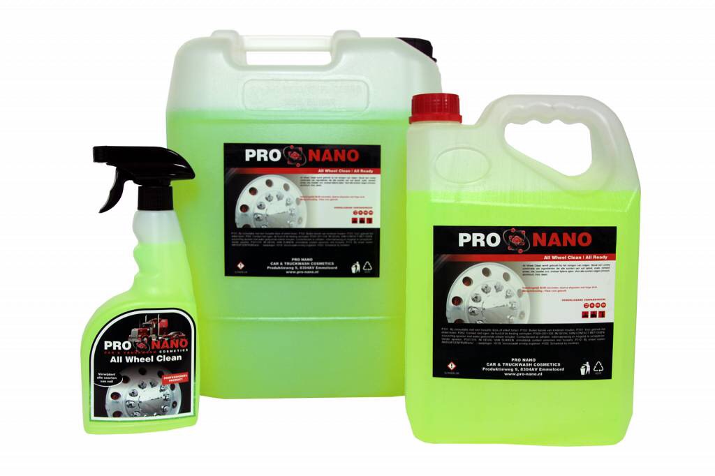

    This stuff ProNano is specifically for Durabrite rims. I can’t attest to its effectiveness.
