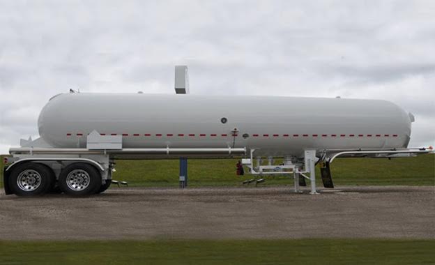

    6A2D37F2-AD03-4D1E-BA5C-C8AB24486C65.jpeg Big difference in pressure trailers for propane, NG etc.
    Heavy steel and different pressure valves. Not to mention the weight.
