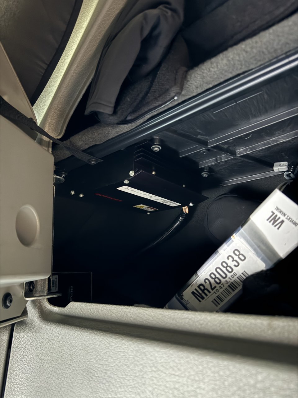

    Hey ,
    Anyone knows where the amp fuse is located on a Volvo vnl 2015 ?
    It’s not on the back of the stereo, nor in the cubicle top of the passenger seat. ( there is just a lighter socket there).
    The only fuse panels I know are the one inside the top of dashboard, the one under hood for outside stuff and a small one in the sleeper at the controler.
    Anyone knows of any other ones ?
    Installed a new stereo that only works now when the ignityis off.
    When I turn the ignition on , the stereo displays “chk amp fuse”
    Thanks !

    It's right there in the upper cabinet above the passenger seat in the last 2 VNL's I've had. This is my current 21. I can feel the fuse beside the wiring plug on the backside of it.

    Same on my 23 VNL 860
