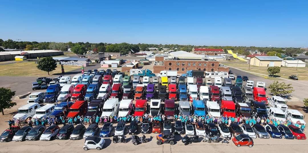

    I bet you are right, but he just wanted it to work. He's not a CBer, but people always comment about our rigs going down the highways (I ain't gonna say "and byways". What's wrong with using a Cascadia for a toter? Most are Volvos because of the Ishift (a lot of the folks never drove a Class 8 truck before getting their toter) and their sharp turning radius, not to mention used ones are plentiful these days. 393447095_10224618703799019_384186150016782302_n.jpeg But, we had about every thing at the Rally from new Petes to old W900s, mostly Volvos though. (The photo makes the sleepers look a lot longer than they are. It is a pretty wide shot. Guess the photographer didn't make the right adjustments.)

    Nice!! You’re right, some of the trucks look distorted. Either way, looks like everyone was having a ball.
