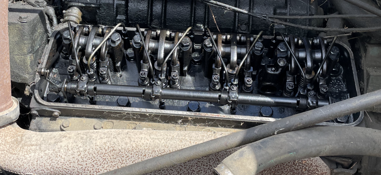

    You referring to the round tube or pipe running from the front to rear of head as the control tube with a bent bracket….
    8F939CFF-C978-4018-AC08-6F89B1CB8FCD.jpeg 8A2D9490-7C64-4601-BEE0-504C0BAF8D95.png

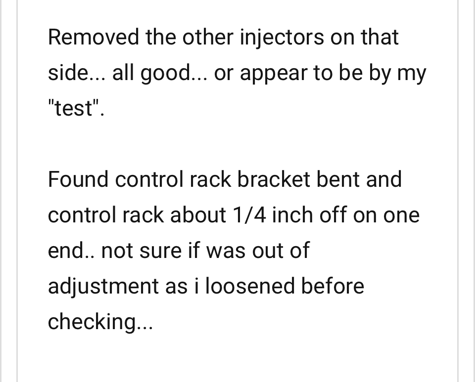

    Yes, someone must have pried on it with something. The opposite end of the clevis pin. The bracket taken off you could see where it bolted to head was bent on the edge about 1/16 of an inch, so by the time it got to the end of the bracket it threw it about 1/4-3/8" off. I am not referring to the offset in the bracket but the mating point where it meets the head. Your pic shows tube parallel to the edge of head, mine was super crooked.... it may have been in correct adjustment though... I didnt check. I should have.
    I do believe the 2 banks are not balanced since I redid the one side. Will be working on that next. Is there a simple way to run the rack? What I did was hold the throttle lever wide open and then adjust them. I found an old service write up says to open the governor, back out idle, Put the wedge tool in to get full throttle, Is all that necessary if all i want to adjust is the rack? I also seen some vids where they just held the throttle open, Its hard to find any info or procedures.

    Well, if that’s the case…. I’d check to insure that all 4 injectors are properly synchronized. They all may be fueling but not synchronized.
    The pic I showed was from my 1980 General, it had set for 11 years. 3 injectors were stuck, after loosening the injectors and priming the heads along with the fuel filter, it rolled over 3 times and it was purring as if you shut it off yesterday…..
