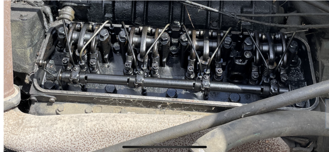

    If you’re speaking of this picture, that’s my 92 series in my General….

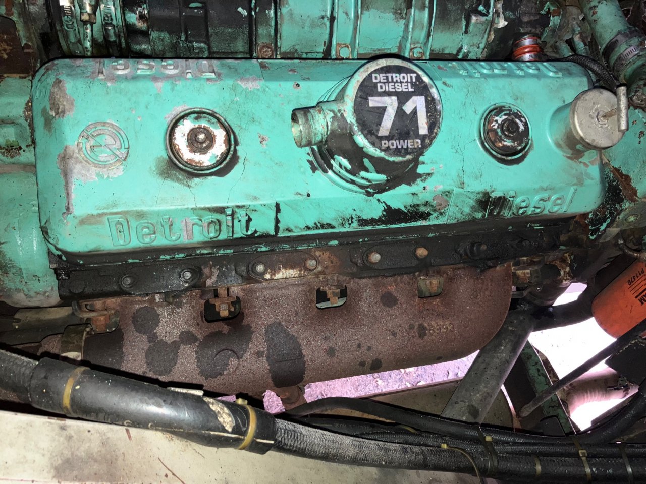

    Was told by previous owner it was 8v92 but it has 71 on the breather on valve cover, water pump ID from somewhere I read looks like 71, and it had N65 injectors in it. Injector height were all close to 1.484 from series 71 spec sheet I found for those injectors. I assumed it was a 71.
    Didnt get over there today. Also found on the other side that does not make the noise is a cracked exhaust manifold, good 1.5 inch long and 1/8" wide by ear. Puffs smoke out of crack while cranking but I think its creating a vacuum while running and adding extra air ... guessing could smooth it out and not make it as percussive?? along with the larger muffler...

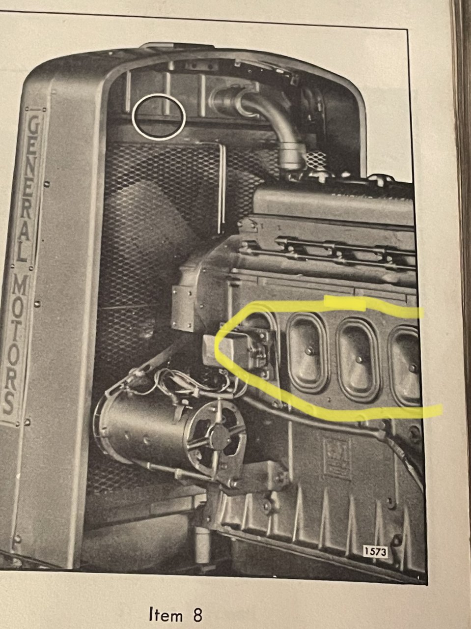

    If you look at the airbox covers on the side of the block the 92 series are cast aluminium the 71 series are stamped steel and their larger. Post some pictures and I can tell you.

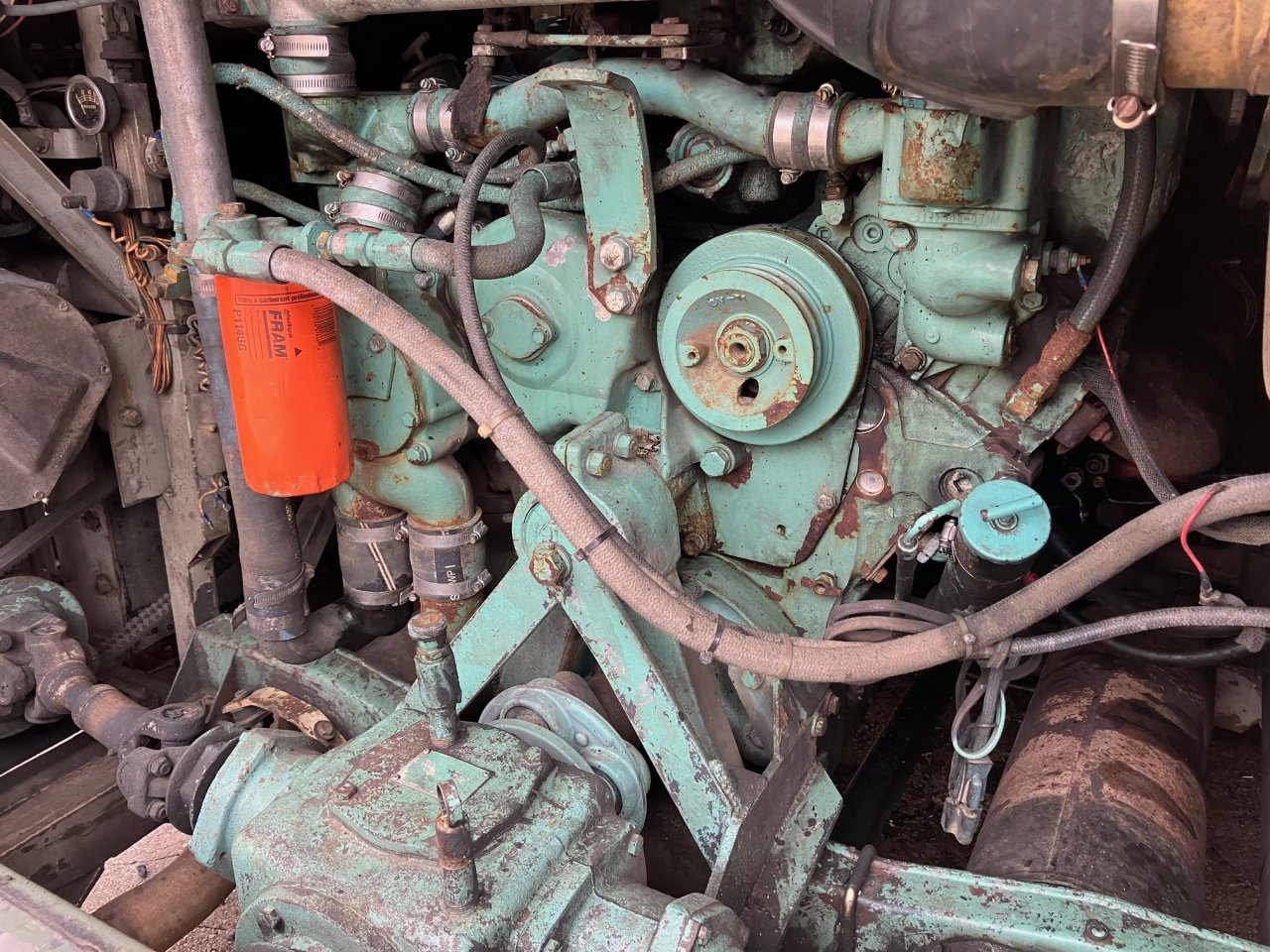

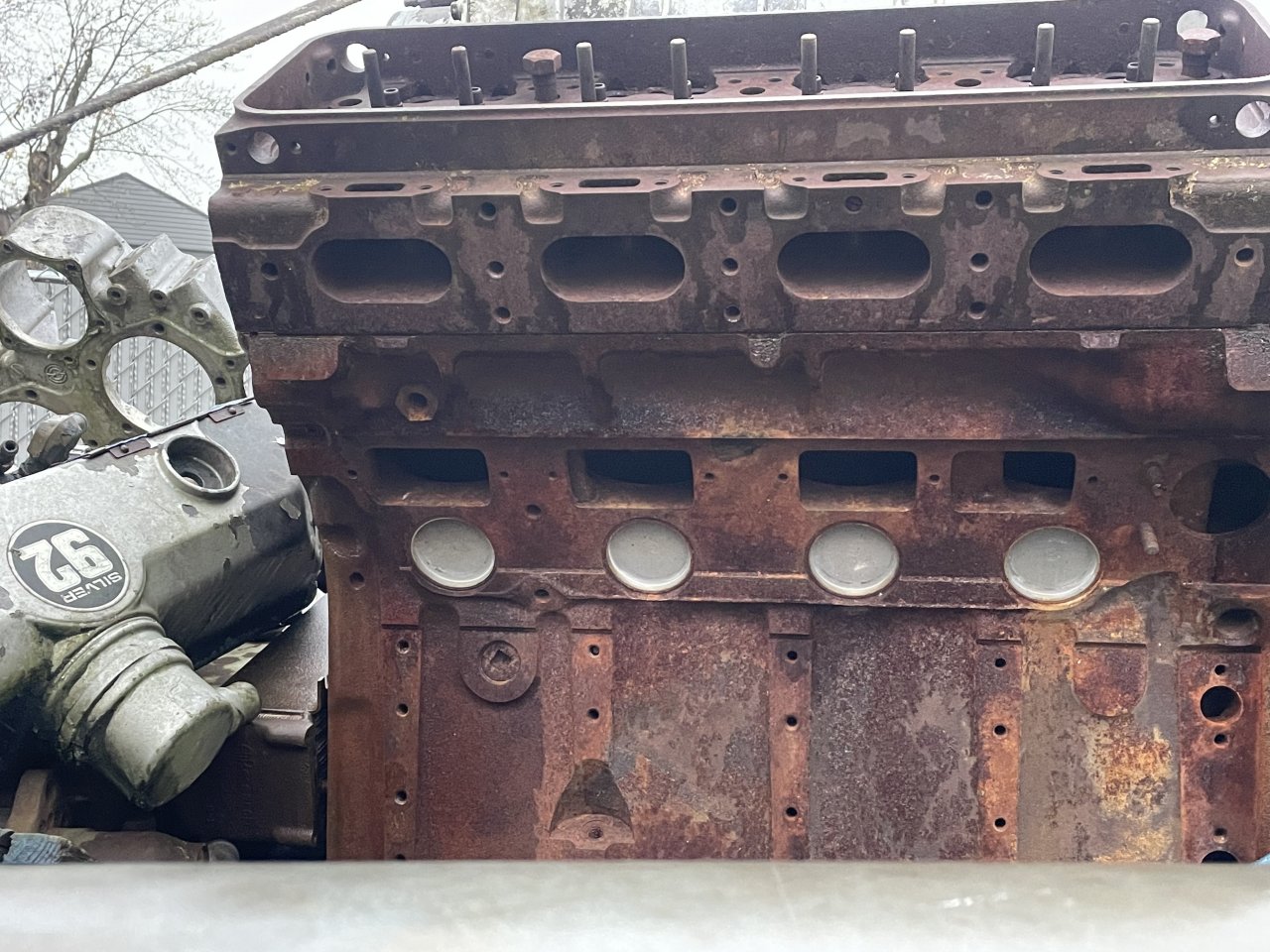

  9. Green461
    Green461 Light Load Member
    151
    96
    Mar 22, 2019
    Southern WI
