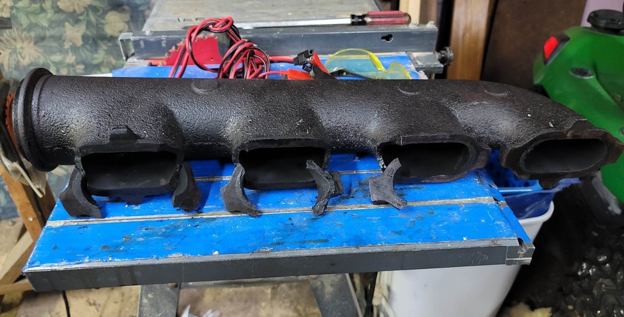

  4. Green461
    Green461 Light Load Member
    154
    106
    Mar 22, 2019
    Southern WI
    Was gone a week, back looking at it. Here is the smooth running side manifold... probably why it sounds so smooth as most the exhaust wasnt going through it. He is going to clean it and sandblast it and I will try and TIG weld it with some nickel rod... depending on how it works anyone know a source to find a replacement? Looks as if the right side and left side are the same, just flipped, they both com out straight. manifold.jpg

  5. BoxCarKidd
    BoxCarKidd Road Train Member
    4,518
    6,578
    Aug 26, 2014
    Repairing that is a bad idea and should only be done as a last resort.
  6. Green461
    154
    106
    Mar 22, 2019
    Southern WI
    Ya it is the last resort. Searched everywhere for one.. no luck. It does not look fun. In a previous life i did high pressure natl gas pipe welding to pass xray and earthquake requirements.. Done lots of misc cast iron repairs... but this pic just looks so old and brittle... Dumbest design manifold I've ever seen. You cant fit a socket on the nuts, cant even fit the closed end of a wrench on, had to use open end and their chinese wrenches flexed and rounded the nuts, borrowed good american made ones and they did the trick. I think i can get it back into shape, I would like to put o-ring grooves around the flanges and put some .020 guitar string in or something to bite into the gasket so as much clamping force isnt needed... as i dont think i can return it to 100% strength...... Had to order nickel filler rod, no one around here carries it, not even Airgas or welder supply. Have to wait till that arrives.

  8. Green461
    154
    106
    Mar 22, 2019
    Southern WI
    That manifold swoops down... you can access all the bolt easy... The one I need is straight out.... where i think the left and right side are the same just flipped.

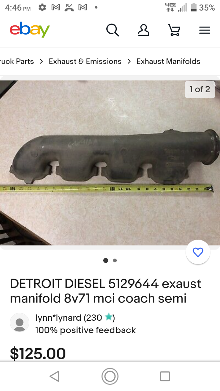

  9. JMon
    JMon Light Load Member
    99
    414
    Nov 1, 2018
    Treasure Coast FL
    Maybe these guys? They don't have a website. Screenshot_20221129-174206.png Screenshot_20221129-174057.png
