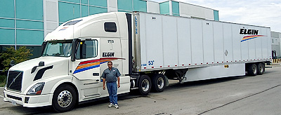

    Have seen a number of these on Challenger trailers and they make it so much nicer to be inside the trailer. Are there any downsides? Would those anti-translucent roof shippers reject it?
    I can't find any pictures, but they put two 2-3" porthole windows on the top sides of the trailer walls.

    On the plus side you could haul watermelons with it. Or pumpkins. On the minus side commodities like paper may not be able to ship in it. I don't imagine they keep all the moisture out ...

    They're water tight. Hard to see in these photos:

    we have a few on the fleet. i have not had any mositure problems they seal pretty good. i have not had any problems with shippers rejecting the trailer. one thing is you might want to get a hand full of cable seals for the doors. i had to seal them all up when i cross docked freight off of a container from Germany on to my trailer shipper policy was every thing sealed up PERIOD. the latch on it wont allow for a bolt seal and a plastic is not good enough for cnd/usa customs regs.
    that load actuly went through the rain and snow 2500 miles not a drop leaked into the trailer.

    Old Dominion's newer pup trailers all have them. Helps a little to see what you're doing in there. I like the translucent roof trailers that let the light in though.

    They have been around for years, we used in hauling blanket wrapped freight in the middle 90's. Much more reliable than a totally translucent roof which has to be replaced periodically and makes the trailer hot as blazes
    Most applications don't have anyone in the trailer that much, but if you are working (folding pads, finding addresses on ltl shipments) they are great.
    Never heard of any leakage or rejection issues. If Challenger, who crosses tge border all the time you are ok there.
