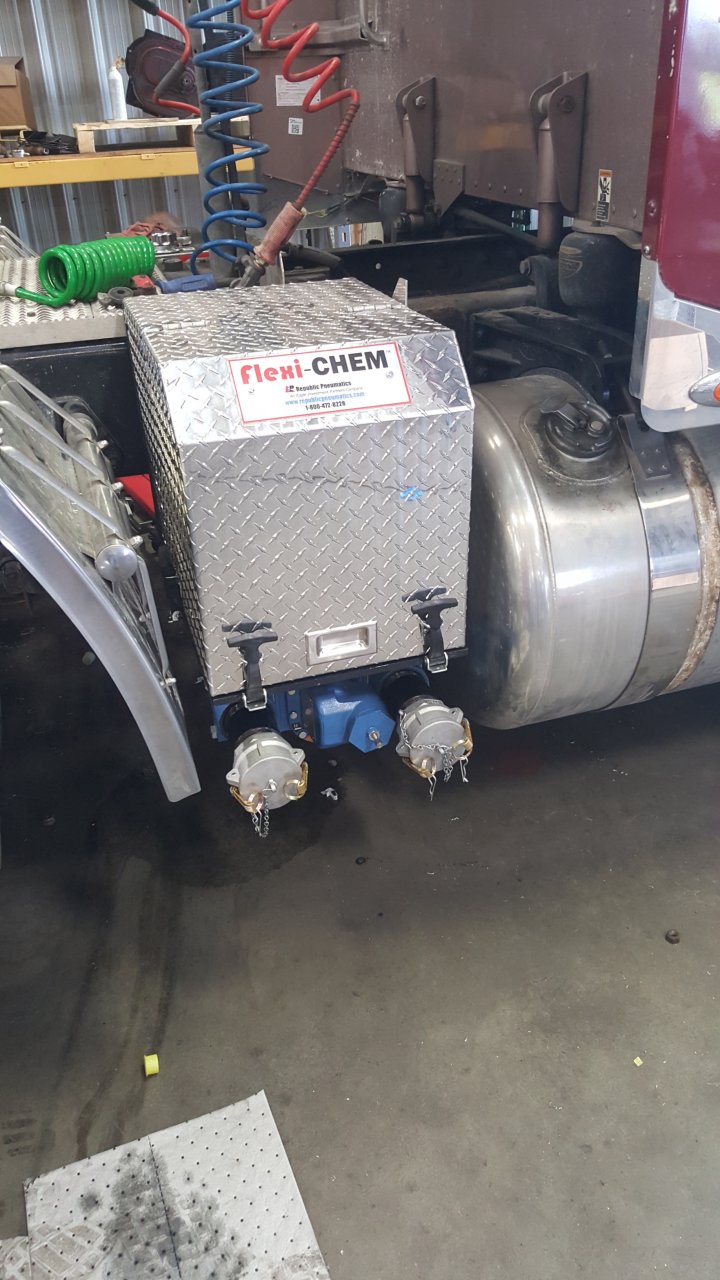

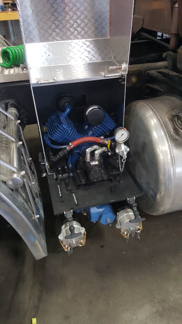

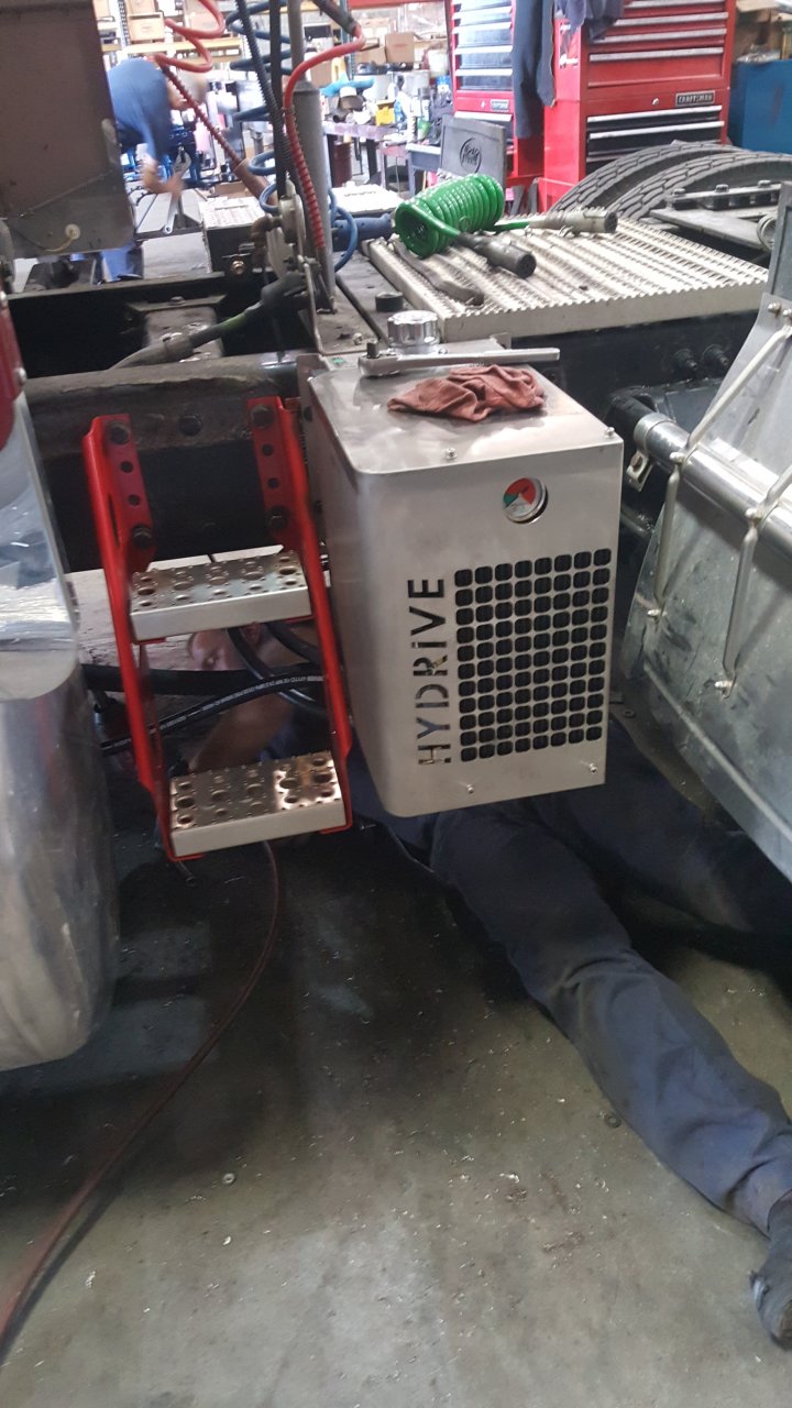

    The place in IN sells this setup. You could also go with a Paragon single unit if space is an issue. I'm not a huge fan of the system, but a lot of guys use one.

    What do you not like about that set up in particular? Also thank you so much for sharing this information guys very helpful! Do you still have room for an APU with that set up on there? Weight wise? How much does that set up add to your gross?
