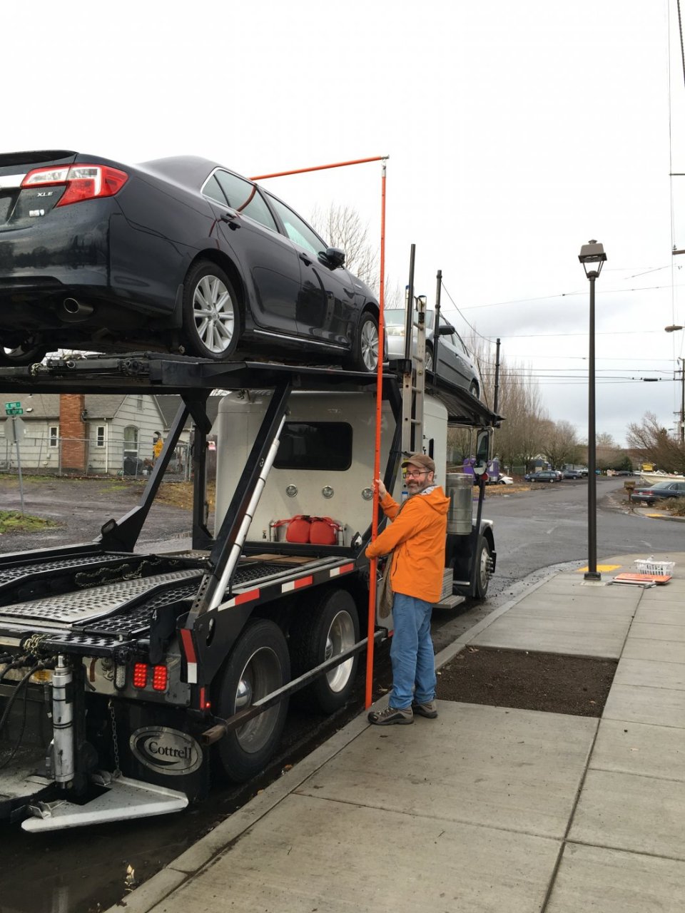

    Get one of these
    Remember when you cut it close on bridges that if the pavement is rough as the trailer rocks it will be a few inches higher on one side.
    Don't cut it close, unless you measure the bridge yourself.
    JoeF2002 Thanks this.

    I was just about to mention that. Back when I worked for the Hitachi dealer a lot of the lowbedders coming in to pick up excavators would pull those out to measure the height before leaving the yard.
