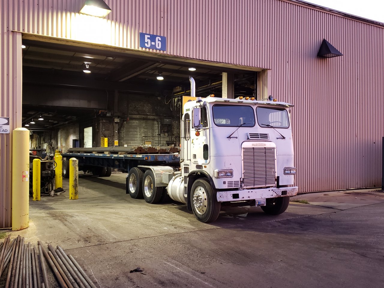

  6. Isxrookie
    Isxrookie Light Load Member
    82
    45
    Jan 24, 2011
    New Orleans, la
    That’s the same truck I’m looking in to purchase. I’ll upload a photo
