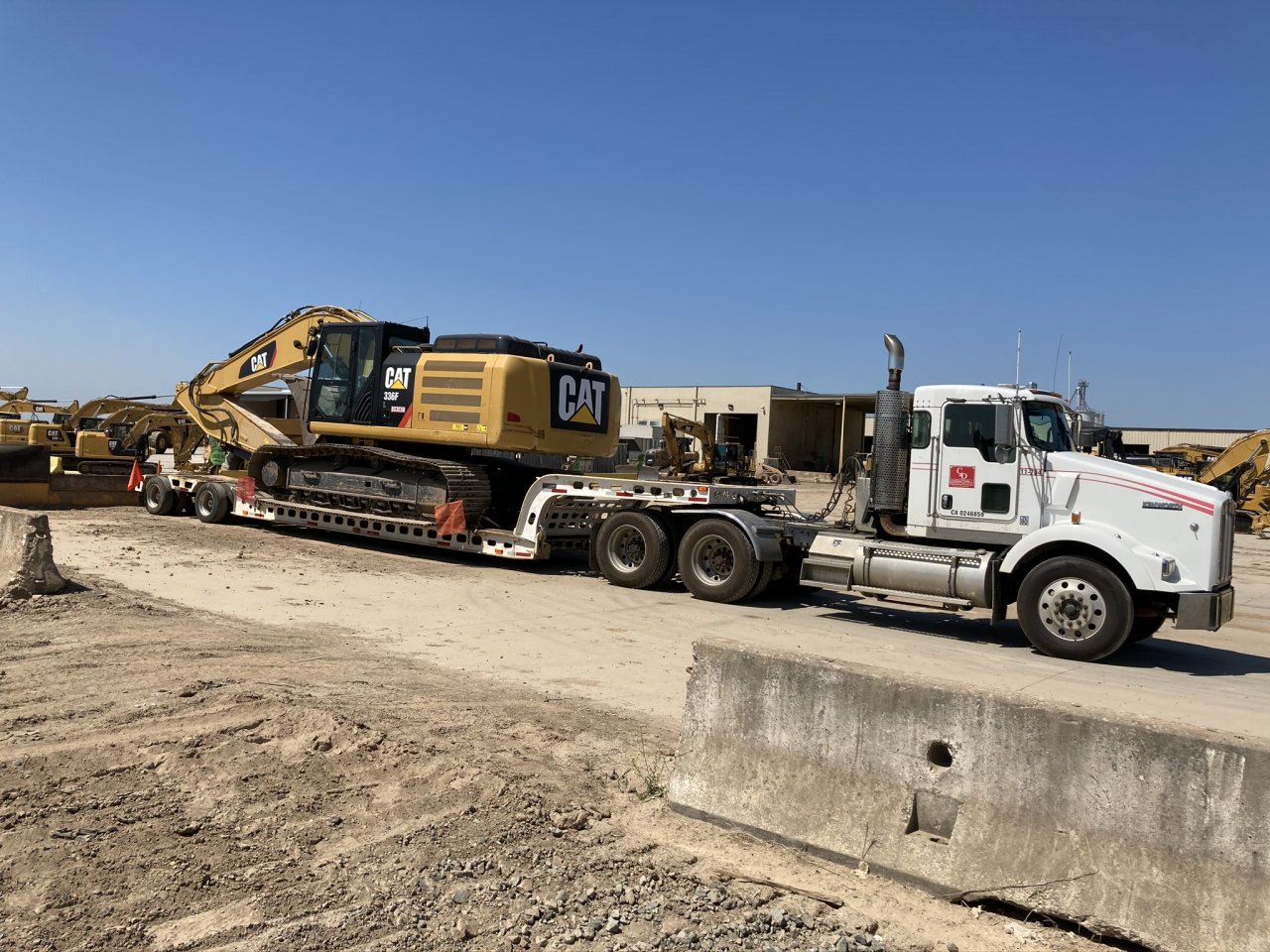

    this is only a 200 but when I load a 290 the same way but slightly farther back it’s almost 48000 on the drives and roughly 130000 gross. This particular 290 has a mulching head and bigger counterweight with wide tracks and weighs roughly 87000 when I scaled it.
    The trailer is 53’ with 9 foot swing clearance and the kingpin is about 4 inches in front of the front drive axle, truck is 248 wb
    A 61000 pound deer 230 puts about 40k on the drives when loaded like the picture.
    Hopefully that gives you an idea.

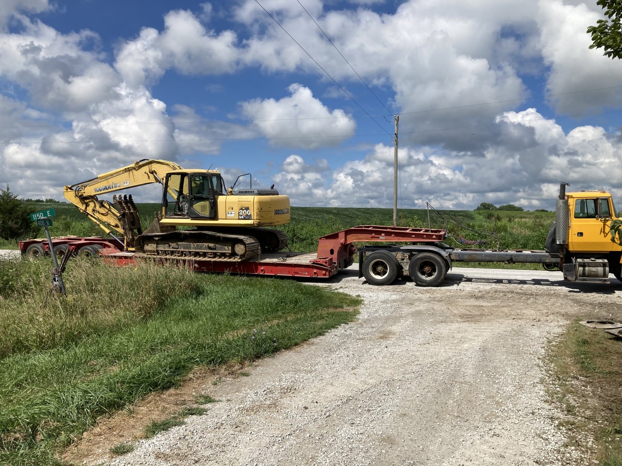

    I rented one that was close to 80k, but it had a quick coupler, thumb, turret guards, and full track guides. It put me at 120k on 7 axles. I would have to guess you would be 48ish thousand on drives and trailer if you're using your 2 axle lowboy, you get it balanced just right, and it is actually 67k. The machine in the photo looks to have a reach boom, long stick, and probably a 2.5 to 3 Cy bucket. I would bet you are heavier than 67.

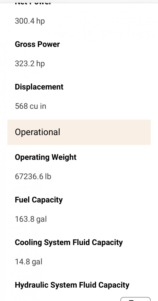

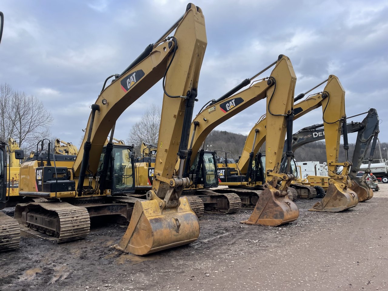

    It shows 67,200 for a 336E L. All 3 have a 60” bucket, and 1 has a quick coupler.
    I’m ok here in WV where they are, but in KY where they need to go I’m only allowed 48K on the drives.
    I can get them the 150 miles to my place ok, just the KY part so I’m gonna get one on and scale it, see where I’m at. May even have to turn the boom to the front and re weigh it just to see….

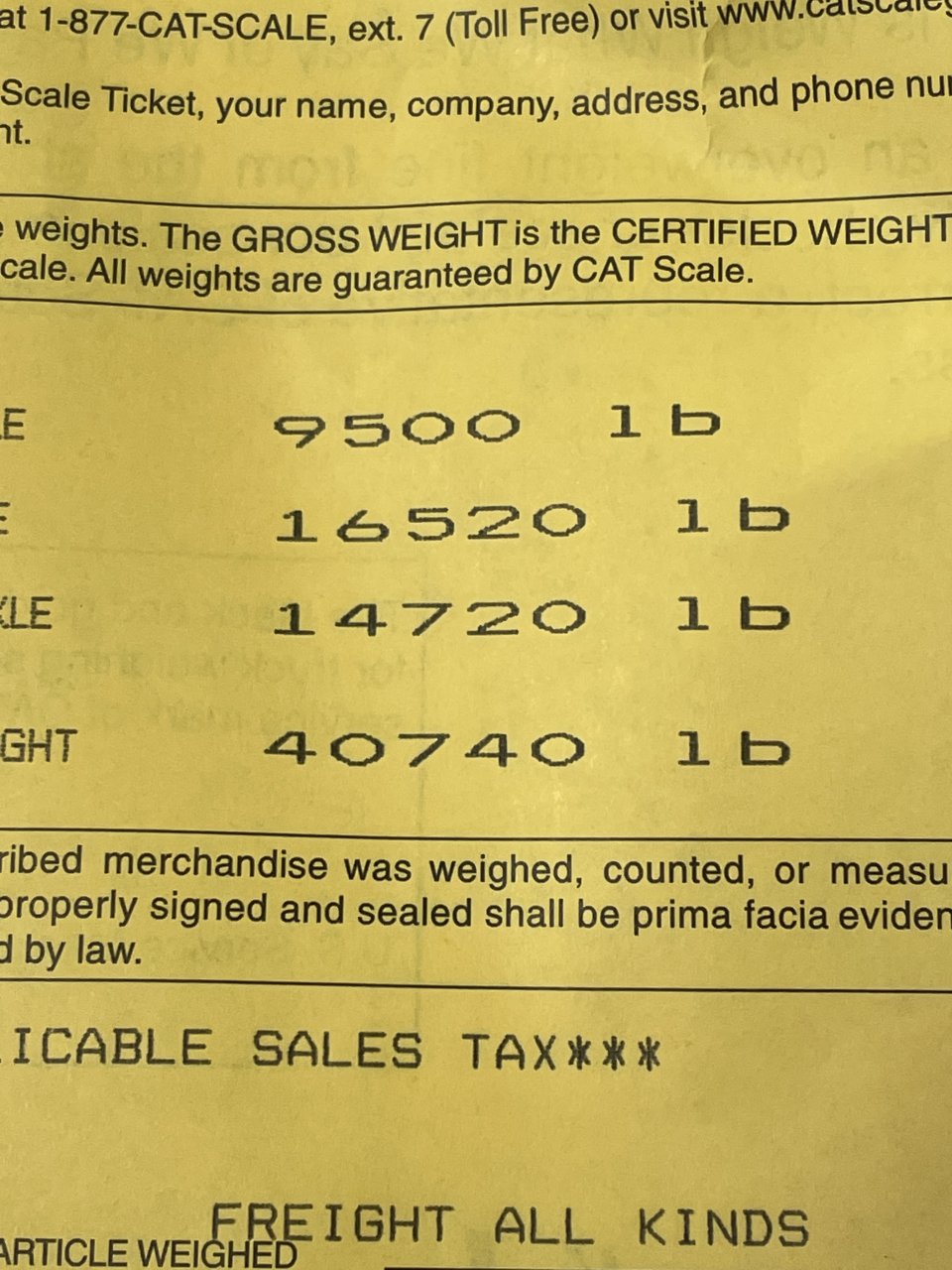

    I went and scaled the 50 ton yesterday with 1/4 tank of fuel…..

    Yea that F model is showing around 80K, that’s definitely heavier. I should be ok on my gross weight, just that darn 48K on tandems in Kentucky….
