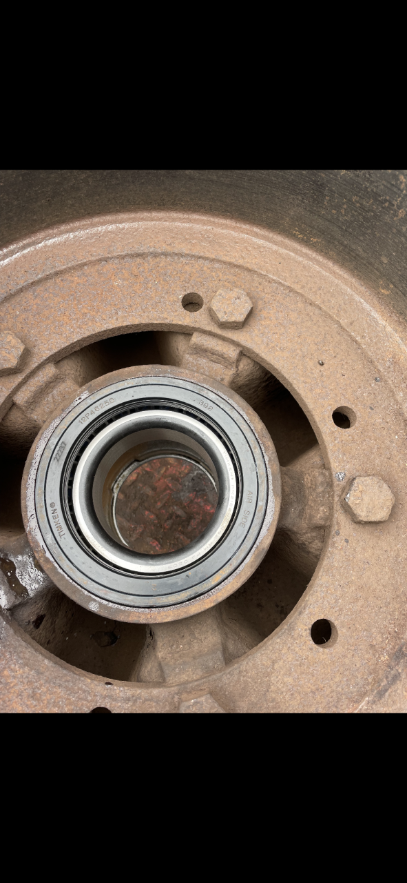

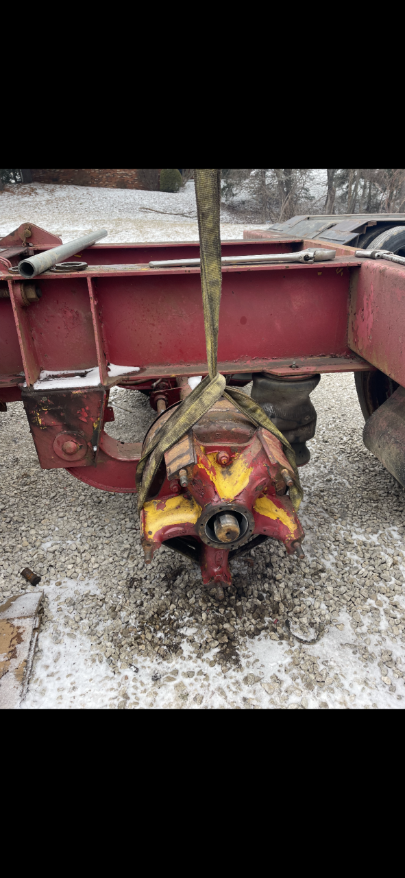

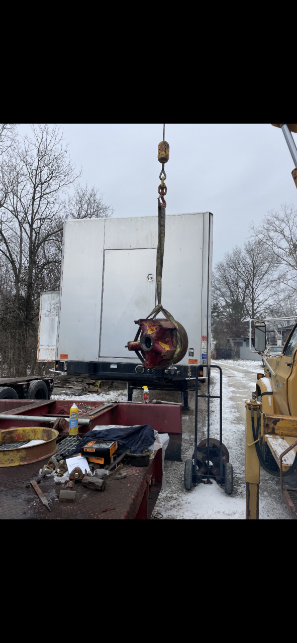

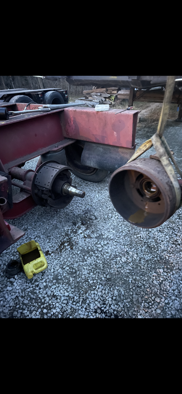

    Haven’t got the chance to try yet. I borrowed a trailer and so help me goodness, I’ve been busy replacing bearings, seals, and brakes.
    I can’t imagine why anyone would let a piece of equipment get in this shape!!! Some hubs had gotten water in them and the rust had pitted the rollers of the bearing.
    Frame wise the trailer is in great condition, the roll around and slow down moving parts not so much lol.
    Maybe I’m just to particular…..

    That's one way to handle those heavy Dayton wheel/hub assemblies!

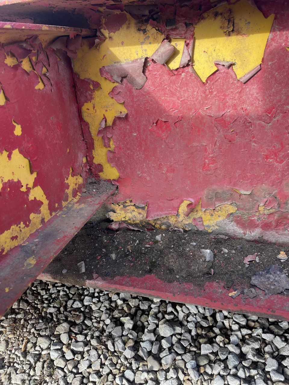

    Not a real good picture, but the frame in the well 10 1/4” or 10 1/2” wide and the top & bottom flange 5/8” thick, frame is 16 1/2” tall. My 35 ton is 7” wide and a lot thinner. Thinking the cross members are 10” tall….

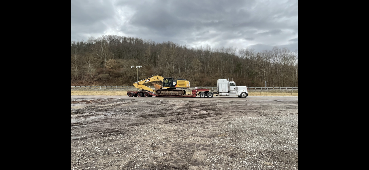

    Didn’t get to scale it, but it was definitely heavy. Bucket of bolts handled it just fine….
