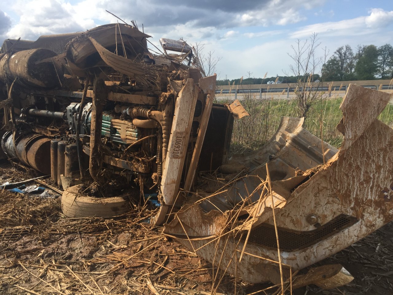

    36E9702F-F573-43E3-8BED-151179AE8E79.jpeg Don’t toy with steer tires
