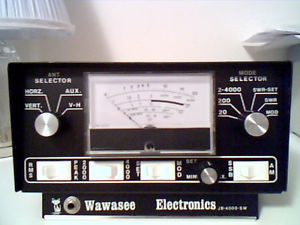

    What about leaving one like this in line?
