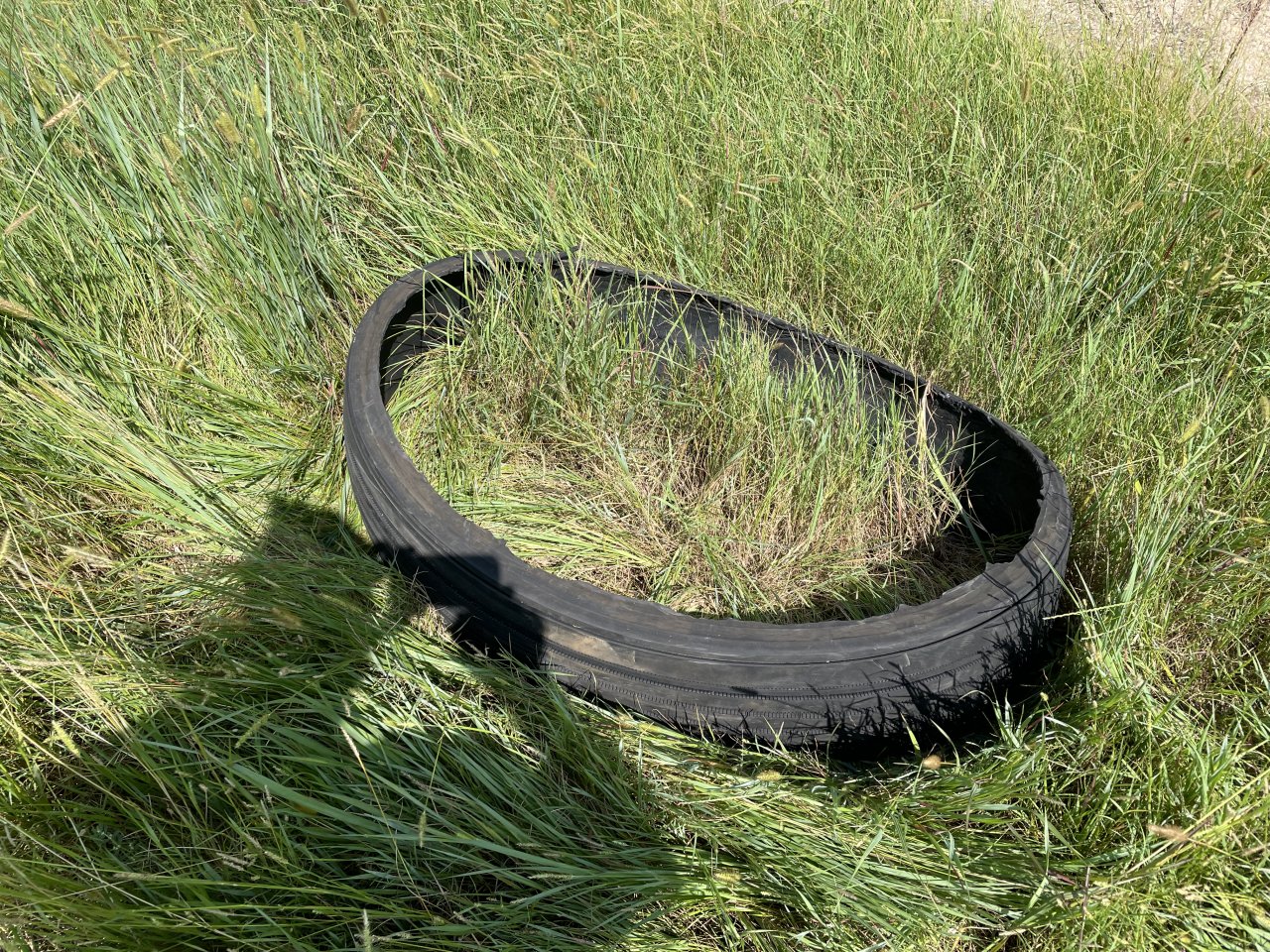

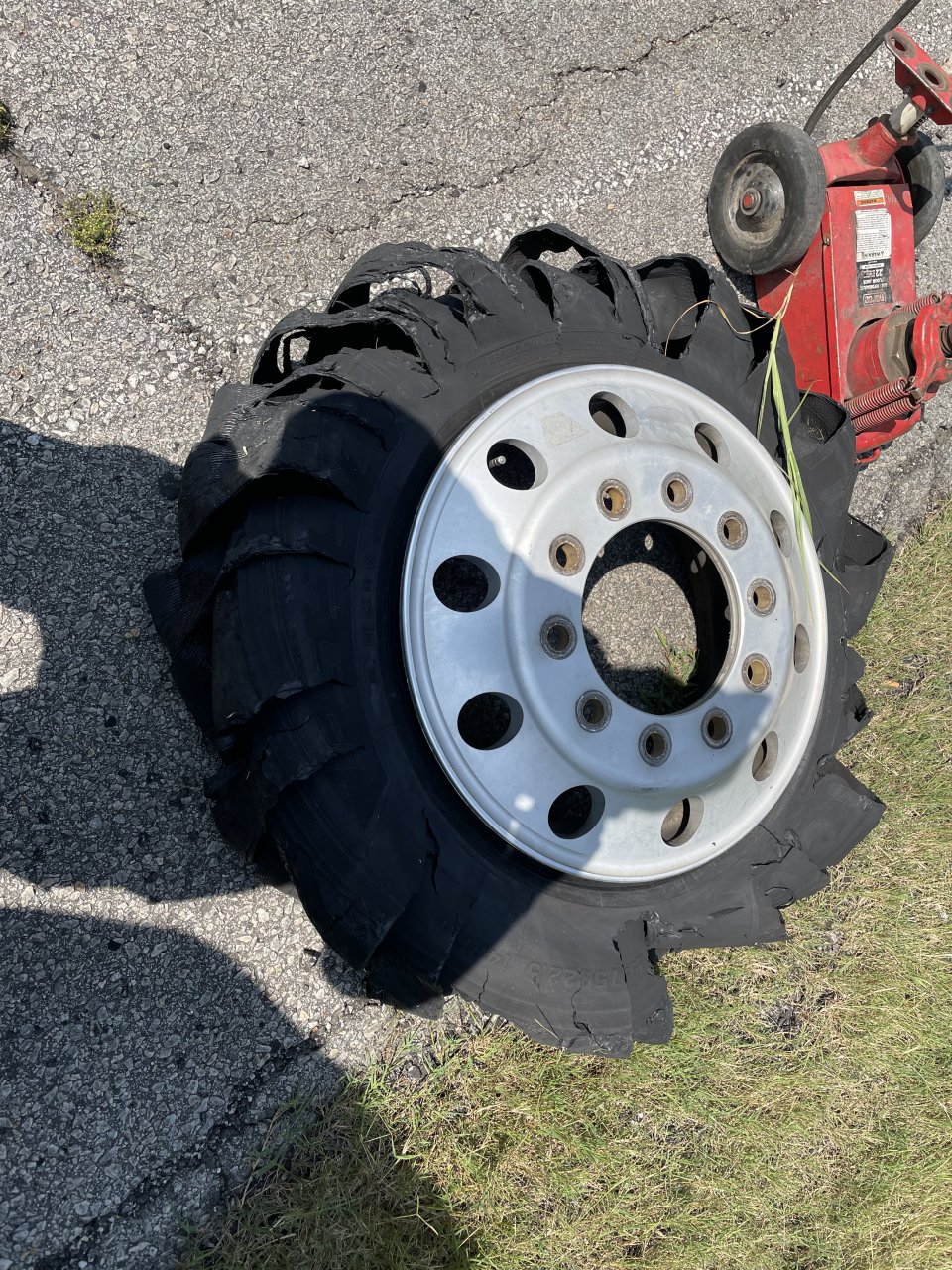

    Look at the steel belt underlayment of the tread for a tear and or rust stain. That will be the culprit. Small punture hole that could not be seen and did not leak.
