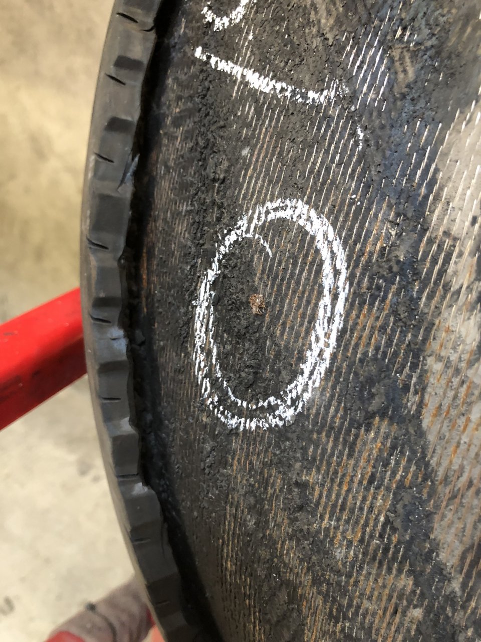

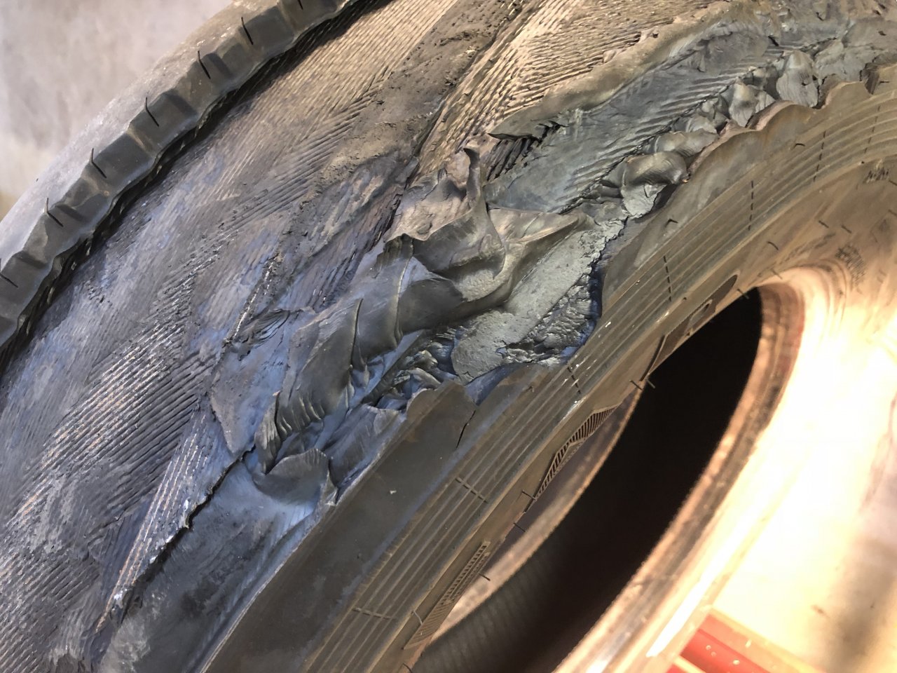

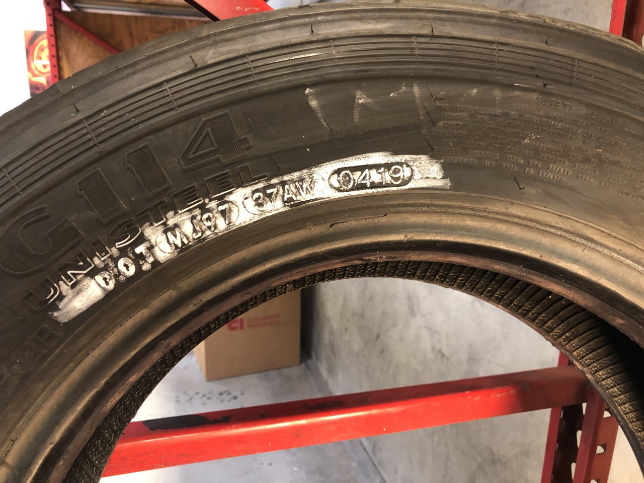

    Took about a week to have one come in. 17.5 LRH. On trailer. Threw tread but did not deflate. Rust mark shows earlier puncture that caused seperation. Rust trails on belts show how moisture gets in eventho air does not leak out. Only 2 -1/2 years old.
    First pic shows the twistoff point about 180 degrees from puncture where the tread held on a little longer and than let go after slapping the crud out of trailer.
