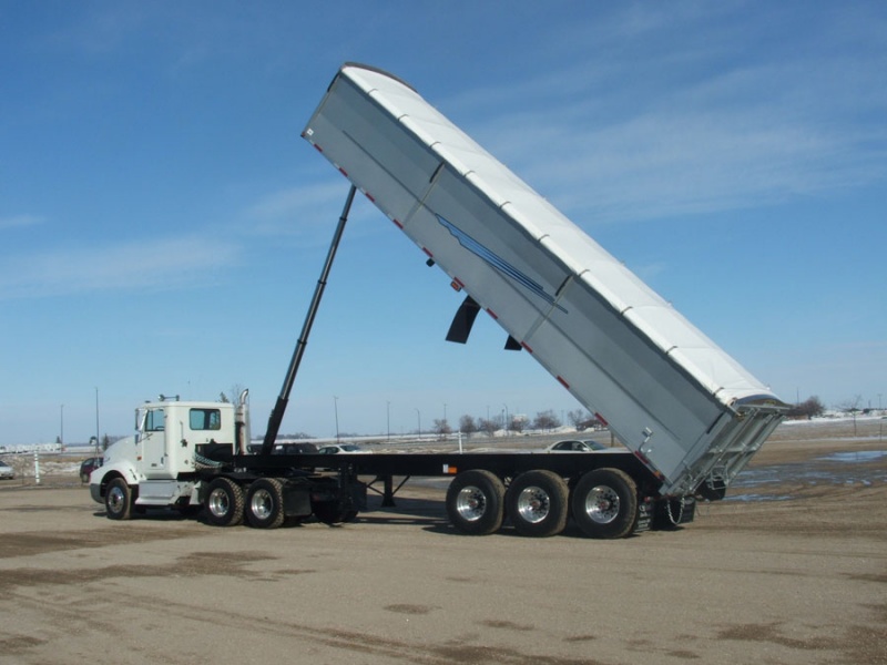

    your quote says end dumps are full, quarter, or frameless.
    and as for the pic that dougknot posted. is that not a end dump on a frame???
    and would this not be an end dump without a frame?

    Yes your correct. The quarter-frame, full-framed end-dumps allow the tandems to stay on the ground. The bucket is connected at the rear to the frame, and pivots there.
    Full Frame and Quarter Frame End-Dumps
    Frameless End-Dump (mine)

    around here, frames don't exist. all end dumps are frameless. and they'll haul anything you want.

    You hardly ever see any frameless up this way. (New England) I think it's a peace of mind thing. Massachusetts, New Hampshire, Maine, Rhode Island, New York and I'm sure a few others allow a lot more gross weight on "reducible loads" such as aggregate or liquid. In Mass. and Rhode Island we run 99,000 lbs. plus 4% tolerance on five axles. The general consensus between us local New England guys is a frame trailer is probably gonna hold up better plus might be a little more stable putting that kind of weight in the air. We make up for the extra weight of the frame with shorter trailers since bridge laws are out the window with the permits. Maine and New Hampshire will allow 100,000 lbs. on 6 axles. Regular tractor with a tri-axle trailer seems to be the normal set-up up there. I run a 379 with a 63" bunk, 3/8" frame 275" wb with 40K rears and an old 1994 Ti-Brook 28' Aluminum body, steel frame. 5 axles total. I can haul 34 tons.
