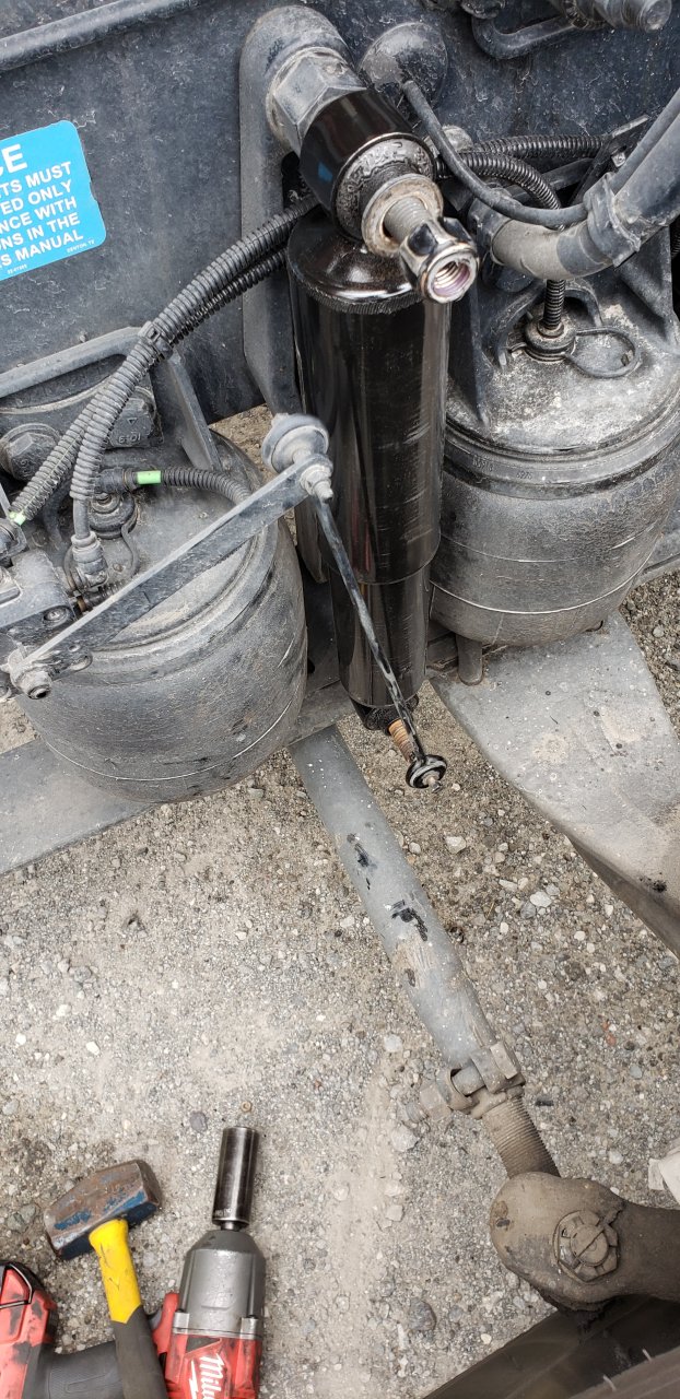

  10. JonJon78
    JonJon78 Road Train Member
    7,216
    42,495
    Jul 1, 2018
    No problems with the air but I did have a problem getting the leveling valve bolt off last year when I changed my shocks...
    Not sure why they made it the way they did but, the passenger side leveling valve bolt goes into the piece that the shock slips over but on the drivers side it doesn't... Kinda goofey.
