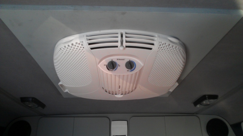

    20 amp breaker under the bunk on the passenger side:
    Martin
