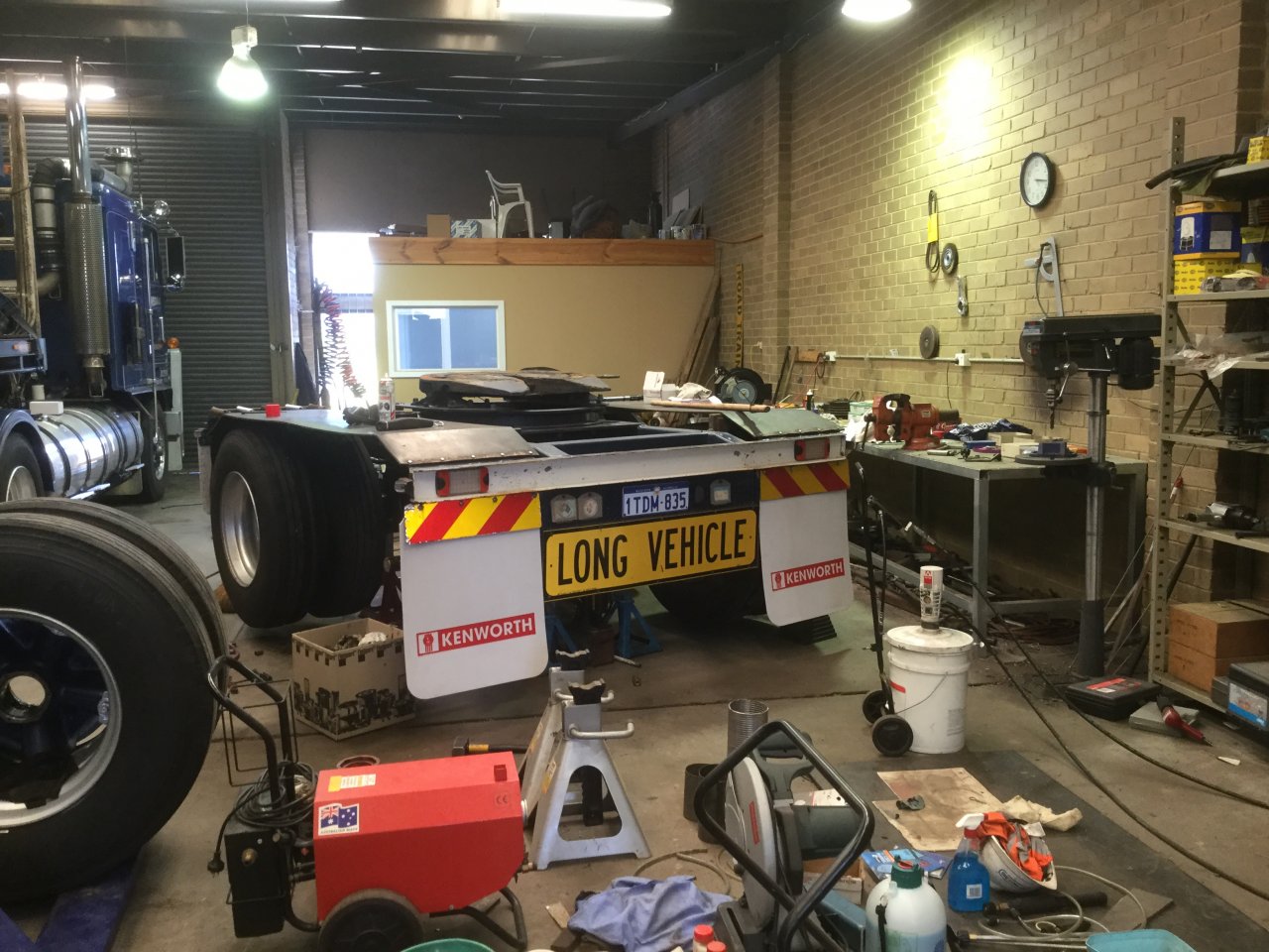

    I also had the problem you are having and the hub must be thrusting into the nut, is it on a front axle of a spread axle trailer or something that could get a lot of side load at times?

    It's off my roadtrain converter dolly. When I am empty I tow it behind the trailers so with no weight on it the bearings would get a hard time.

    The other problem we have had is that the bearings look good but some sort of stress has distorted the bearing cage enough to allow the bearing to thrust under load and jump around. Everything looks good but the tolerances just aren't there once things warm up and it's really hard to figure out why, in this instance just replace bearing and nut. The only way it could have a wear ring is its spinning on the spindle so that's no good either. My vote is new bearing and nut for peace of mind.

    I agree, just replace the bearing/races and nut. Bearings aren't expensive and certainly cheaper than downtime.
