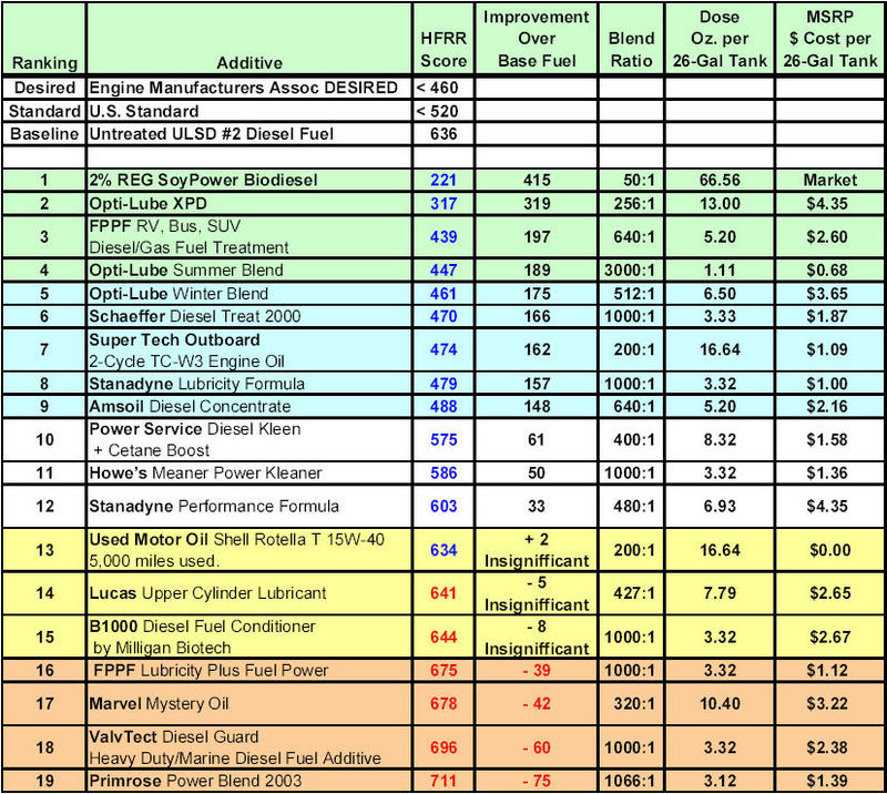

    Here is a table with some test results for fuel additives. I found this on The Diesel Garage and it was posted by a member named Tank. This really made me think about the normal additives...Lucas, Power Service, and Howe's.
    I would run the Schaeffers. Their winter treat is the best I have found so far and my ACERT is pretty picky about fuel and additive.

    That table sure doesn't rate Lucas very high, kind of a surprise for as popular as it is.
