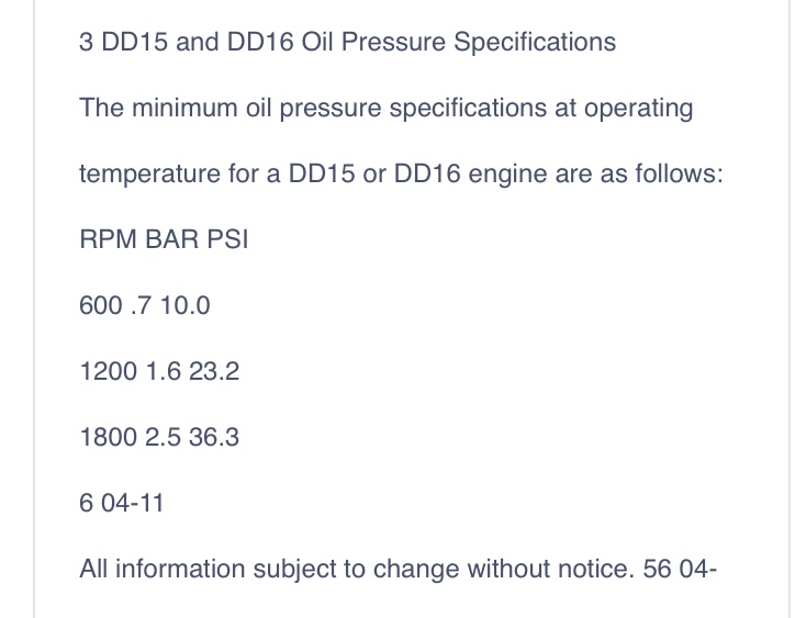

    My dd16 has 10w30 in it, I’ve been thinking about going to something a little heavier, due to the fact that my idle oil pressure seems low at 14psi hot

    If that's below the minimum spec for hot idle, heavier oil is nothing more than a band-aid. If its within spec, who cares. Some engines are low pressure and high flow.

    You might be due for o-rings on the oil pick-up tubes. It's a known issue with DD13/DD15/DD16.

    10 psi is the minimum idle oil pressure.
