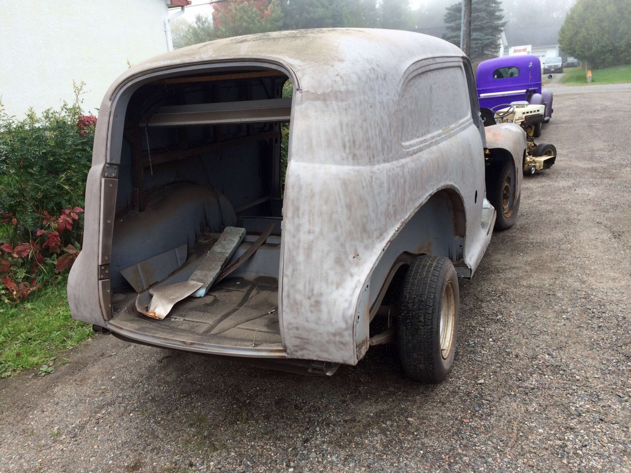

    Sandblasting the frame is easiest, fastest and most effective. You could farm the work out but for $2K you could buy a compressor large enough to keep feeding a pot blaster. Once bare spray with a coat of epoxy primer. If you dont get the frame bare you will be revisiting your work constantly each year if the vehicle is exposed to the elements,,salt etc.
    Wear a respirator under the hood if concerned about your health regardless of what media used.
    Ive done a few frame off restorations, and always have a project vehicle on the go..Sandblasting is the most fun you can have with your clothes on..my last being the most sheet metal…’48 chev sedan delivery.. IMG_2679.jpeg

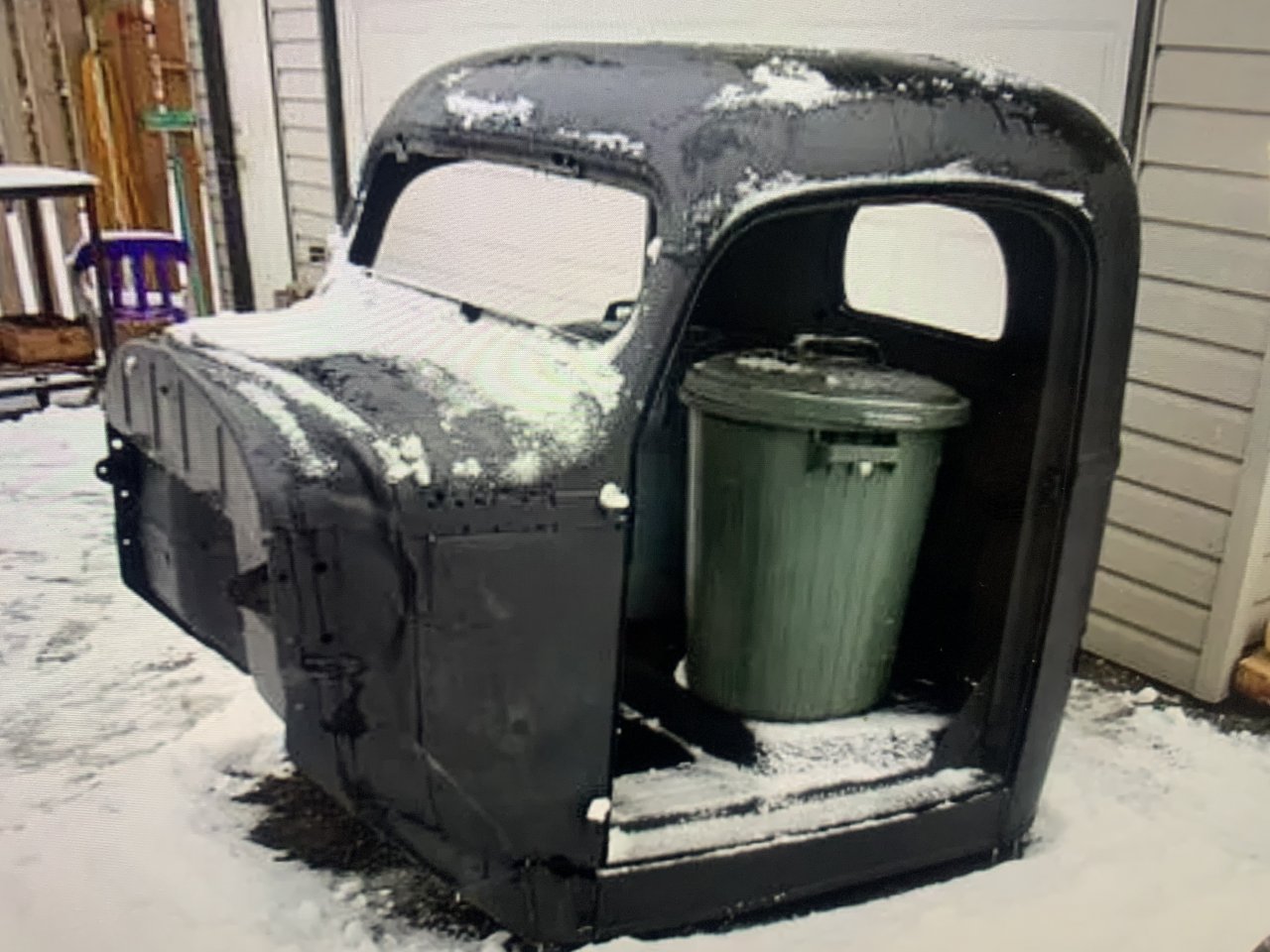

    I use Fine Black Beauty..always sift it through a screen first,,,only takes minutes to screen 50 lbs,,always find some chunks that are large enough to clog spray gun and ruin the moment
    Sent junior to get acrylic urethane and he was told “thats old hat”. They sold him ACZO NOBEL U350 .its a 2 stage industrial paint that dries so fast you can wet sanded and buff the same day…hard as stone and reasonable at $400 1.5 sprayable Imp gallon.
    Im familiar with ACZO NOBEL E350 epoxy primer,,its premium product..brake fluid has no effect on it..it’s my go to primer for my own vehicles. For others i use Kirker epoxy primer,,its good…I left this cab outside for 5 years in Kirker primer..did not chalk at all..
