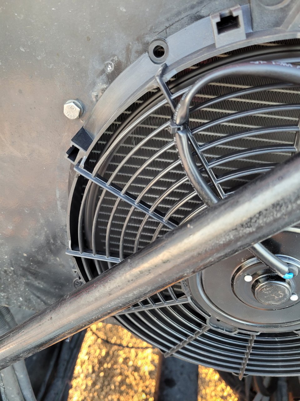

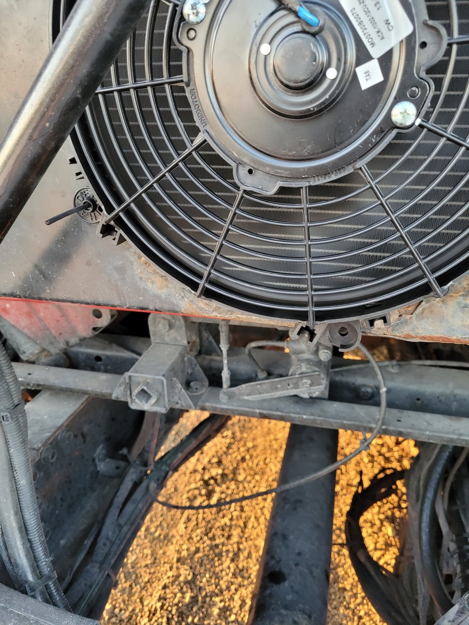

    CODE IS AC5. I just replaced the fan from O'Reilly auto parts which is $73.the holes aren't lined but I used one bolt from the old one and the rest is zip tied, EASY tested working good.the tri pac engine was working for 1 to 2 minutes and shutoff and giving me AC5.am all good with the new fan now good luck guys. I am posting the pictures.
