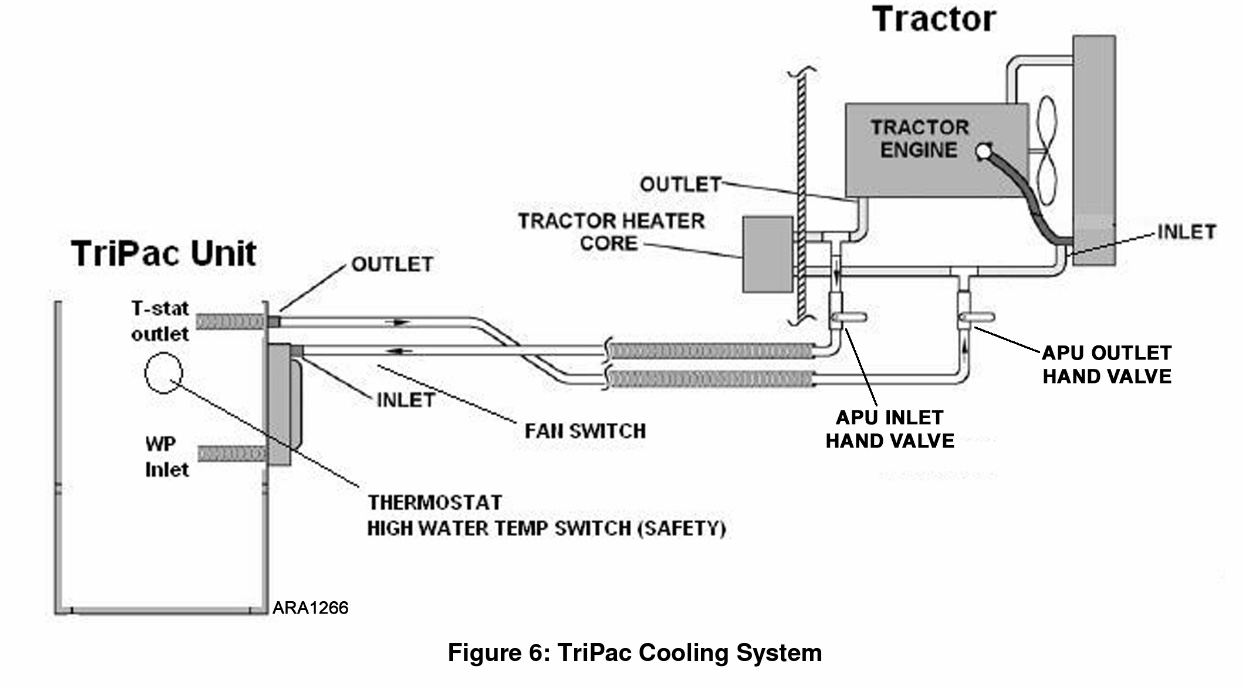

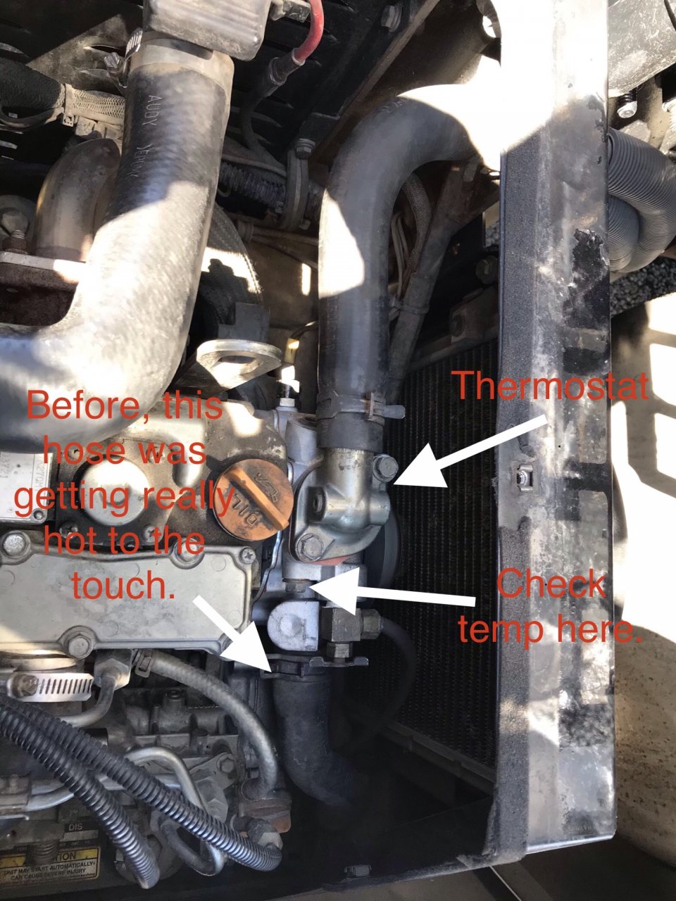

    I think I have my terms mixed up. I am referring to the fan that is installed next to the APU (not the one commonly installed on the back of the cab).
    truckdriver31 Thanks this.
  10. PE_T
    PE_T Road Train Member
    It seems like this will solve the problem. I’ll give it a try and report back.
  11. PE_T

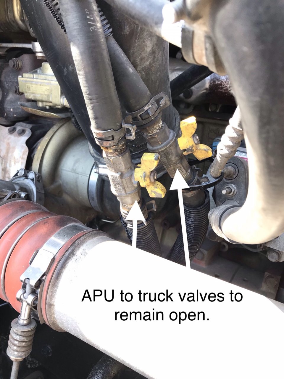

    PROBLEM SOLVED
    Thanks everyone for your help.
    @truckdriver31
    You were right. The two valves under the hood need to be open when the APU is in use. Closing them causes the APU coolant temp to overheat. I recently did some work on my truck where I closed them off, and left them that way because I was incorrectly told that it wouldn’t make any difference. Thinking about it more, it really makes sense to have them open because it allows the APU access to about 13 gallons of coolant. The temperature by the thermostat now fluctuates between 125 to 135 F, which is good. The alarm gets triggered if it goes over 170 F.
