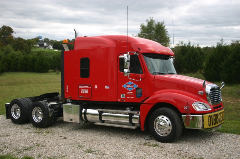

    We are at $2800 right now, and it is removed from the truck already. He said the only thing I would need to install is the T fitting on the fuel line for the generator and heater. Everything else is there with it and working, according to the owner!
    Next will be finding and installation and user manual for the specific Tripac I guess, although I doubt it can be that hard if the parts swappers at dealers can do it:biggrin_2559:
    Martin

    My 2006 Columbia mate.
    Will be a tight squeeze, as I have 300 gallon tanks, and a toolbox on either frame rail!
    I have the plasma cutter, welder, and so on to make it work though.....I hope!
    Martin

    Gotcha...ya got the twin 150 on your truck i take it ...and im assuming you have the tool boxes towards the rear ...

    A picture is worth a thousand words etc...
    I will have to lose the steps on the passenger side to mount the APU for sure.
    Martin

    wow tite fit there Left...yeah gonna have to lose it for sure...Glad ya got it for a good deal...

    I measured a Schneider drivers Tripac in a rest area a few weeks ago...after asking of course:biggrin_25523:
    I just have enough room if I lose the step and it's stupid hook bolts. If I space it away from the frame a little, I will have a few more inches due to the suspension brackets etc.
    Martin
