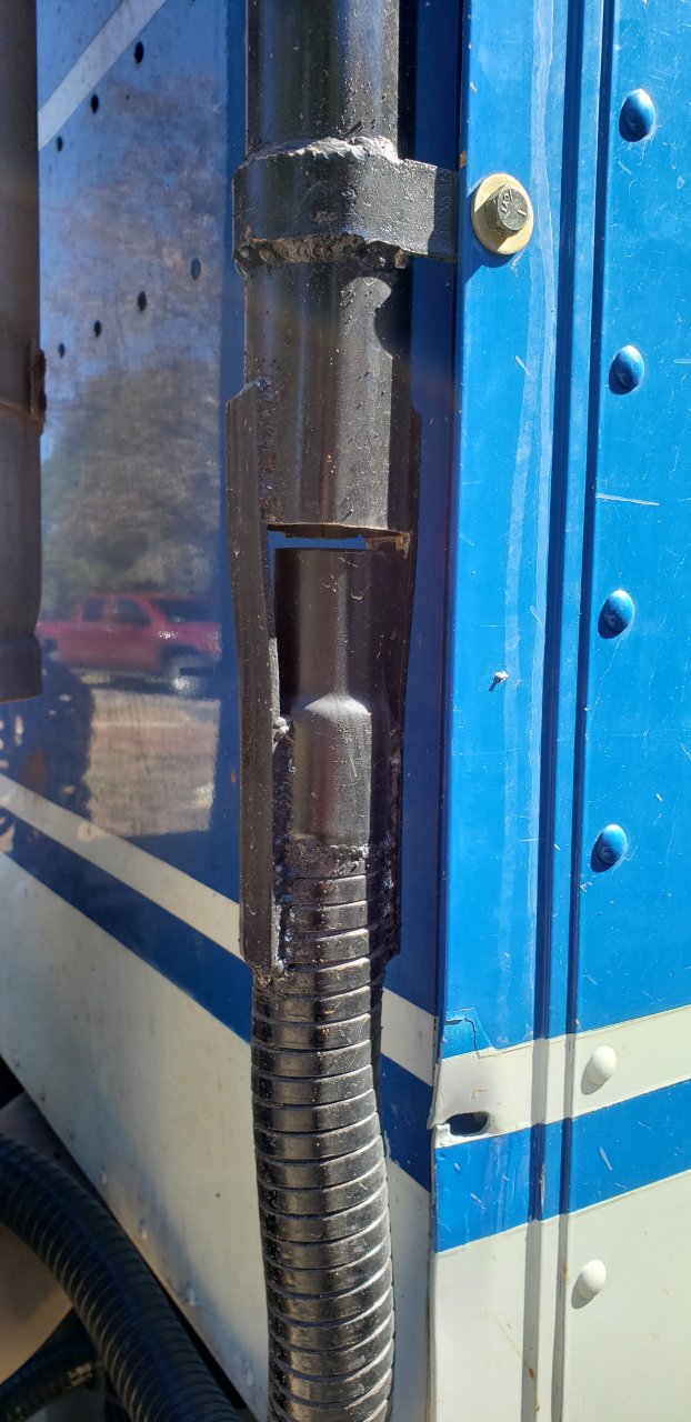

    I run a generator and carry 7.5 extra gallons of gas. Then I use a window A/C unit I fabbed a bracket for. 20201120_120912.jpg 20201120_120844.jpg 20201120_121048.jpg 20201028_142755.jpg 20201028_142745.jpg 20201028_142732.jpg

    Why the gap in the stack? Just curious

    It's a venturi. Drags in fresh air so the gas engine exhaust is more diffused when it exits the stack. Helps keep sleeping truckers on this side of the dirt.

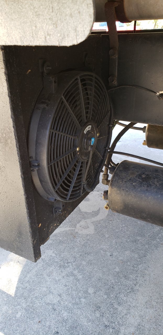

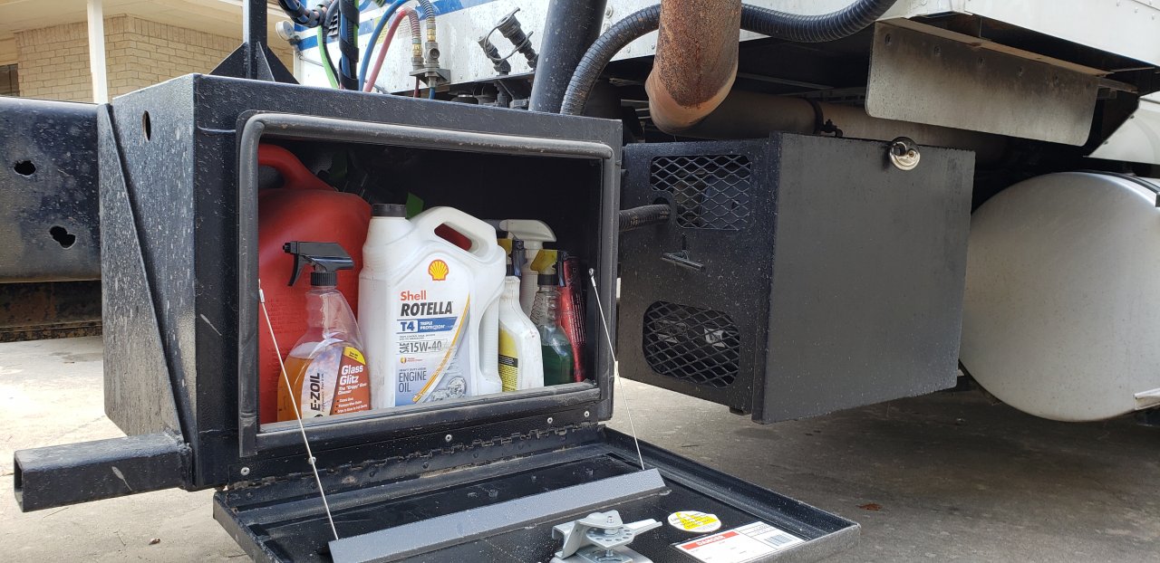

    Well I decided to go with the generator. I welded up a custom box and mounted it to the frame behind the cab on the passenger side. Generator is bolted inside the box and has a lock on it. Ran a weather proof box on the outside of the box to run an extension cable inside the cab. I went this was becuase I liked the idea that if it got to cold out, I could plug the block heater in to help keep the truck warm at night.
    Generator is fairly quiet when box is closed. 3500w generator. My last part of finishing the project is attaching an exhaust pipe to the generator and running it outside the box. Generator dies when the lid is closed (even with vents) due to the box fillin gup with exhuast fumes.
