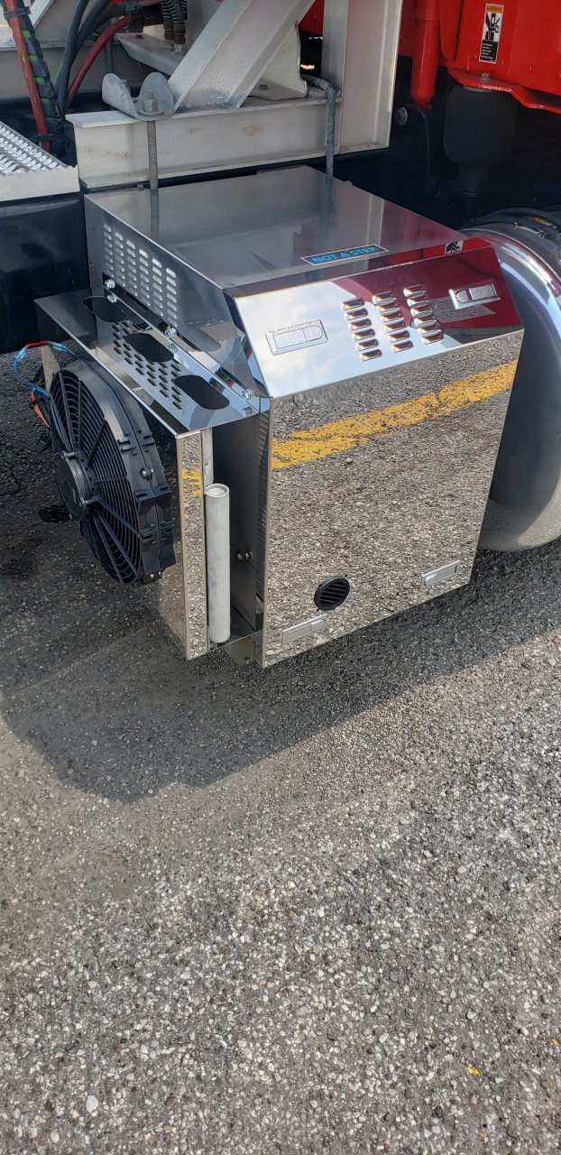

    Just had my Dynasys fixed this morning. After 4 years the engine mount bracket cracked from rust. Sounds like a new apu again, I'm guessing it had a crack in it for awhile with how it rattled so much. Had an aluminum condenser cover installed too while I was there.
    armo, RubyEagle, msh and 3 others Thank this.

    looks yummy...

    Very nice

    Yeah that looks sharp,!
