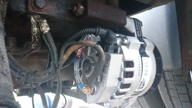

    Will the Chevy conversion work with a tripac evolution. It has 2 sensor wires that are on the original alternator now where wld I hook those hook up?

    I'm really not sure I got the idea from someone on the internet over 2 years ago

    Talk to a altonator shop.
    Or look online at thermoking parts and see if we use the same alternator mine was the Bochy 42 amp used in 2009. Than do a google search for "GM ALTERNATOR IN A THERMOKING APU"

    Hey buddy. Do you have a detailed pik on how you wired the pigtail. I only ask so i can you it like a guide....
