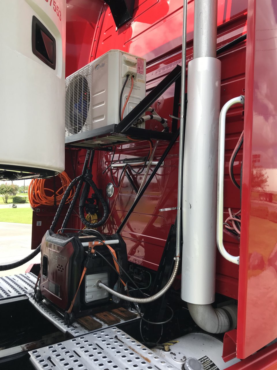

    Mine is somewhat hillbilly, but only cost $1500 or so to build. It runs on about $5 a day in gas. And no huge hole in the cab.

    Put a headache rack on and none of those setups work at all unless youve got a tall tall cab and dont mind tripping on the generator on the catwalk (snails generator is a good compromise with the space, but the full outside condenser from a mini split is still too tall to not go over the top of the back of the cab with headache rack, beleive me, i TRIED to find a shorter one)

    The new Honda I replaced the Predator with, is much smaller. I could easily hang it off the frame rail if I didn't have room on the catwalk. The condenser is another matter. It needs hard lines because it runs 410a. So either your cab would have to be solid mounted or it has to be attached to the cab.
    A mid-roof running flats, etc., would be able to do a roof mounted camper style though.

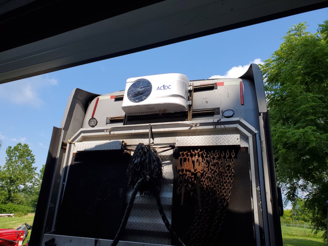

    Defeats the purpose of the midroof somewhat, 11' 7" at stacks and beacon light
    Work in progress

    True but there is also this new invention called adhesive. ;)
