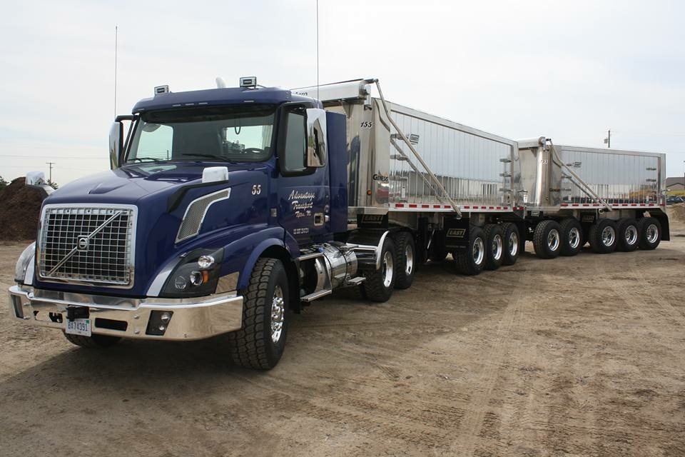

    D16/iShift
    My former employer got it on the road a couple weeks ago. There aren't many applications that are harder on a driveline. I'm interested to find out how performs, especially off road.

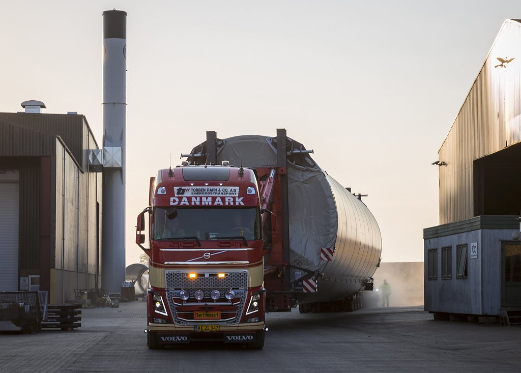

    150 metric tonnes load
    I shift.
    No auto's in heavy haul???
