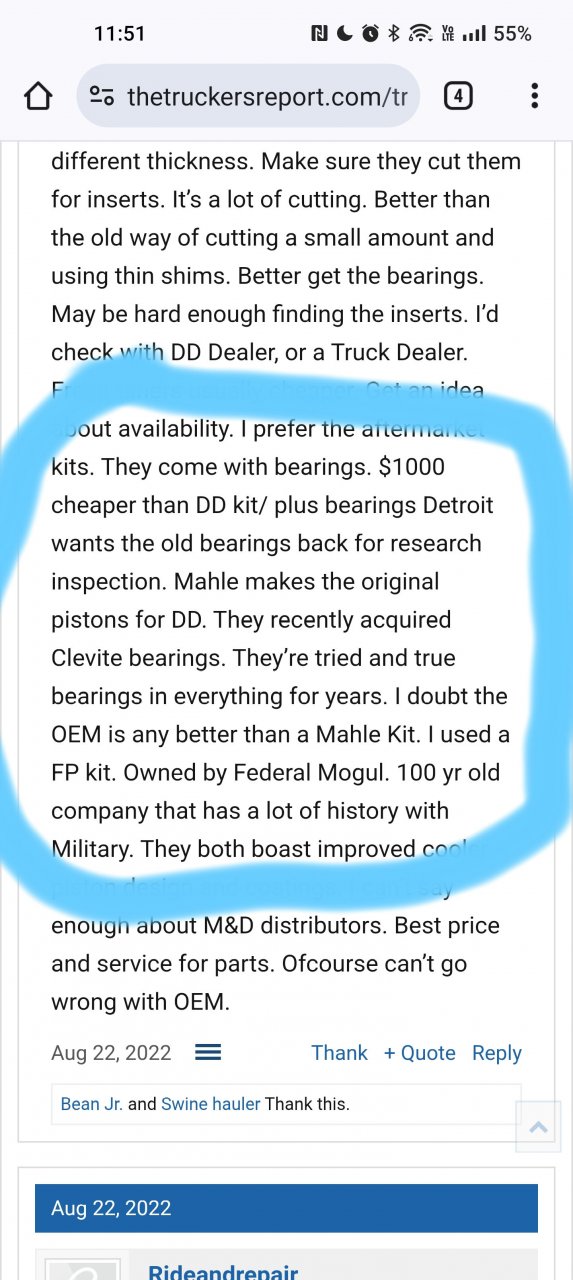

    Screenshot_2023-10-26-23-51-29-97_40deb401b9ffe8e1df2f1cc5ba480b12_1.jpg Also, what inframe kit did you use, original Detroit or Aftermarket? @Rideandrepair
    Found your old post. I wonder if aftermarket kit is the reason for engine failure. I have seen it before where rebuilds only last 200k miles with non original parts

    The kit I used was FP Diesel. Federal Mogul company. They also own felpro, so I imagine that’s the brand of head gasket. Should be good. The head and block inserts used for counterbore are DD. They were a cut correct. Deck heights all at .004. Head is DD reman. Bearings aren’t the problem. The only other thing is if a liner is pitted and leaking. If so, then yes it’s because of cheap metal. Though I know of a Detroit that had a pitted liner at 70k under warranty. My first Truck had a Cat, it had a liner replaced under warranty before I bought it. so It happens. I won’t know what failed till it’s apart. More than likely the heads cracked. I don’t think I’ve let it get too hot. Did have the hole in the radiator a while back, but I don’t think that caused it. I’m hoping it’s a cracked head. That’s the best case and most likely scenario. If so, I won’t buy another DD reman. I’ll buy a brand new aftermarket. I’ll also use a Mahle head gasket.

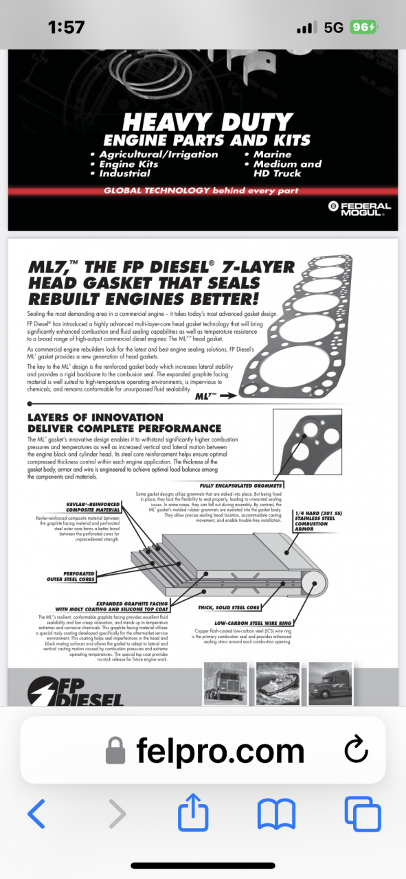

    8DB29D72-F474-43CB-9785-241EC5435E96.png Here’s the gasket I used. Sounds good to me. felpro has been around forever. I doubt DD makes their own head gaskets. No reason mine should have failed. Must have cracked the head. Maybe when I ran with a patched up hole in my radiator. It never got hot though. I’ve been told that sometimes coolant gets cavitated, temp gauge doesn’t always read accurately. I have had to add a few gallons since then. Radiator seeped a while till the gaskets sealed up, Then there’s always stubborn air pockets, requiring adding more coolant after running a while. It’s hard to tell. Probably never know.
