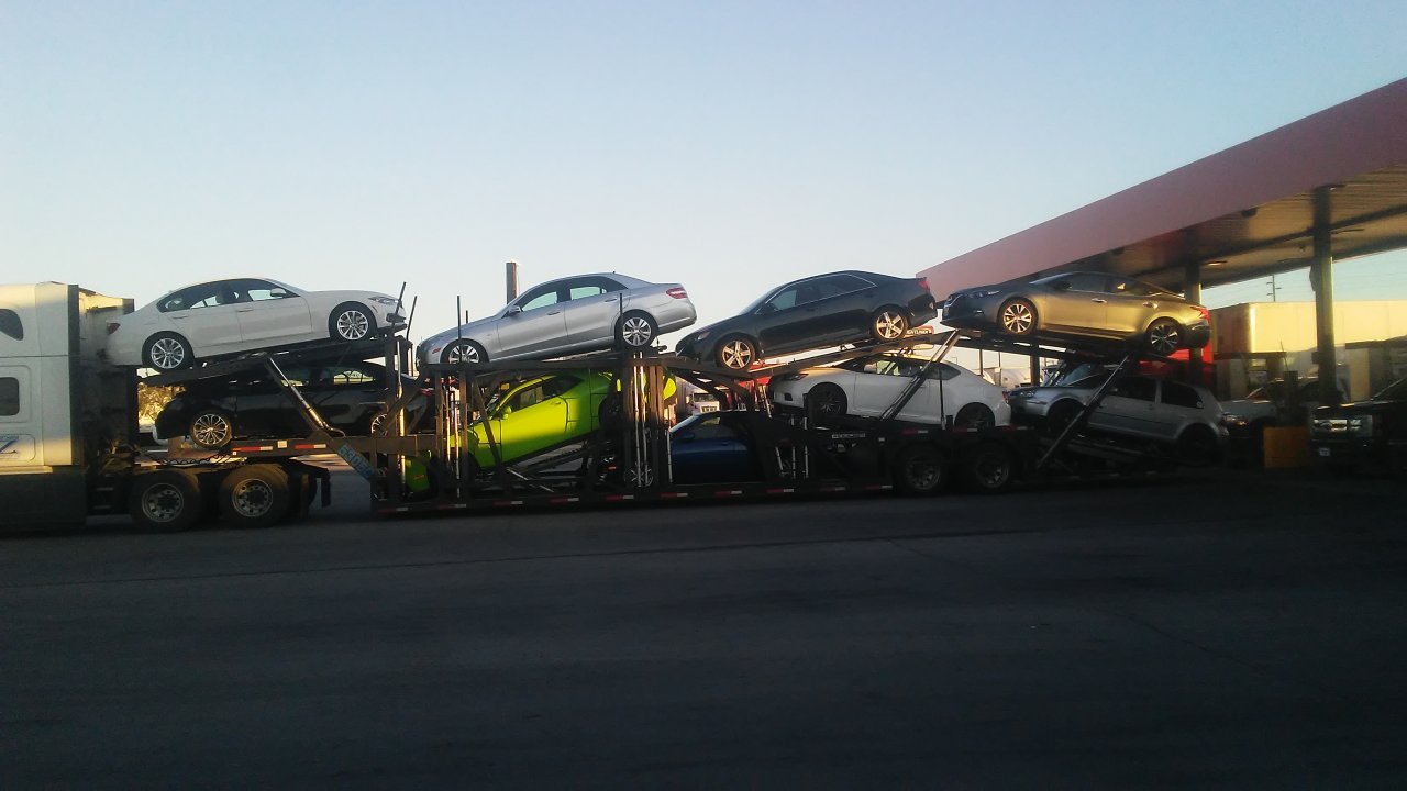

Hi everyone, I am back with some update:
After one month local team work, I am left solo with a 5309 trailer doing POVs coast to coast . Loads are from CD. This is how I self trained myself. The first trip I only load 7 cars on the 9 car trailer. I was studying how to load while working with my trailer. I didn't load 9 cars on trailer untill this month. I have a couple of month experience now NO single scratch. But I do have a few close call. Once I tried to slide my 5th wheel to bring down my trailer axle weight. Bad ideal.
The 5th wheel rail is rusty and automatic transmission is not able to crawl. The whole trailer go all the way to the front almost crash the No. 1 car.
Just like guys said here, do it slowly! You can figure out car hauling by yourself.
Now my dispatcher want me to go into new york city because he can not find good pay load other places. I am wondering how to answer him.BigBob410, Hulld, Banker and 1 other person Thank this. -
Congratulations on learning by yourself. When a carhauler tells me they haven't torn something up, I usually think to myself they are lying, but in this case I will say good job as you have accomplished what most of us haven't. As far as going to NYC, I know what I would say but some people like going there. That 9 unit load looks nice. Stay safe.
