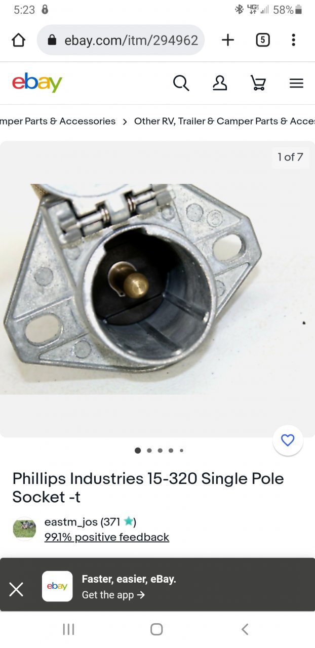

    It's really easy. I have attached everything you need with the exception of solder, and a torch. You run the cable directly from the battery to the socket. Measure the approximate length from the battery to where you are going to mount it. Then order a foot or two extra. Screenshot_20220616-172808_Chrome.jpg Screenshot_20220616-172410_Chrome.jpg Screenshot_20220616-172808_Chrome.jpg Screenshot_20220616-172348_Chrome.jpg Screenshot_20220616-172410_Chrome.jpg

    As what @bad-luck says.
    It’s exactly what and the way I run my hydraulic pump for the lift decks on my car trailer.

  11. bad-luck
    bad-luck Road Train Member
    3,357
    6,206
    Nov 16, 2013
    Baltimore, Maryland
    All the lift gates that I have ever seen have a single prong. The electric cord for this set up is referred to a stinger cord.
