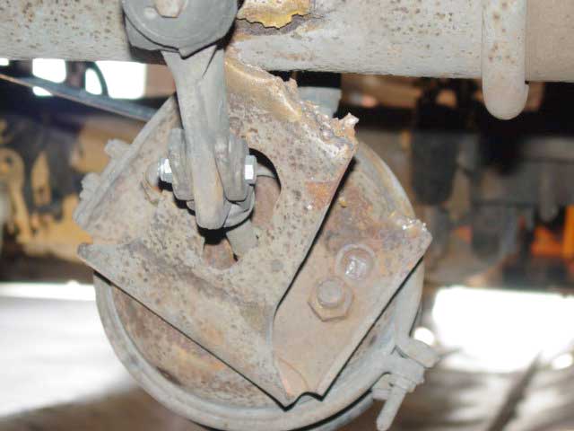

    IMG_1638.JPG The reversing while braking has no effect on brake adjustment. Unless you call tearing the chambers from the axles an adjustment. Never ever attempt that, it's not how they work.

    Hm. Nice picture. And pretty strong postion too. Even I must concede that point. However... habits die hard. I have not ever.. er... lost a brake due to this method of quickie adjusting. Ive only been formally inspected for stroke length 4 times in my life time So just the behavior trying to be sure that the brakes are somewhere in the vicinity of being adjusted this way is exceedingly rare in my 50 plus years on this planet.

    That picture shows a failed weld bracket above the chamber onto what I interpret as the frame. Do you have another perhaps a better angle?
    I think due to metal fatique property and physics that brake chamber assembly would have torn loose at some point that it actually went ahead and did as the metal bracket above got tired over time and finally snapped.
