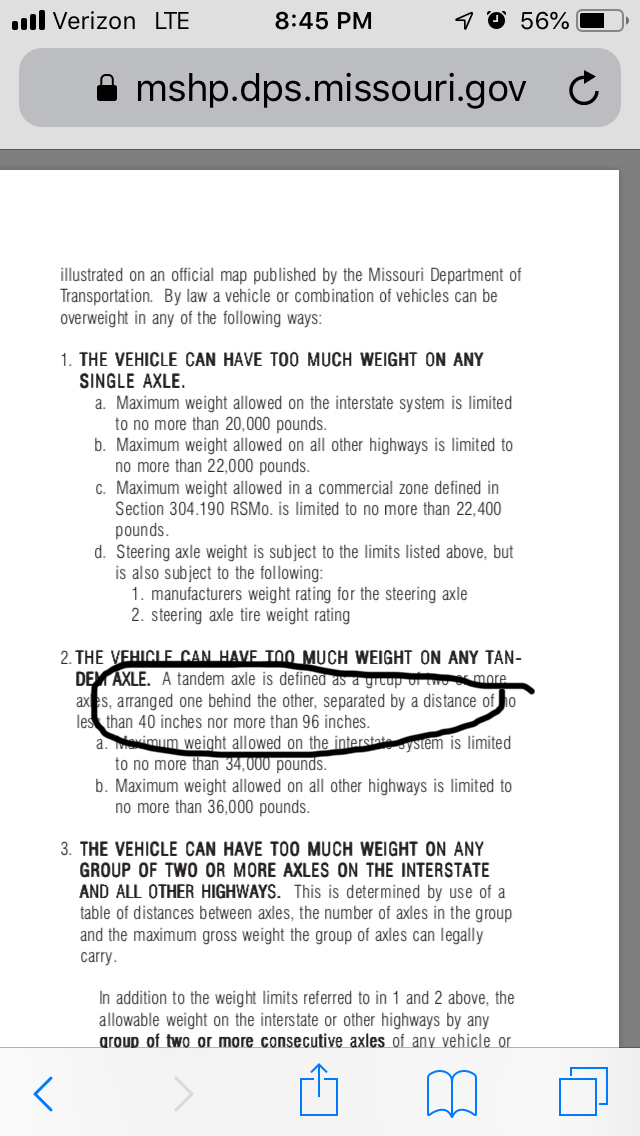

  11. kylefitzy
    kylefitzy Road Train Member
    4,631
    19,156
    Aug 12, 2007
    Kansas city,Mo
    Well now you have. They are not a group. Here’s a clip from the Missouri website.
    Humblepie and D.Tibbitt Thank this.
