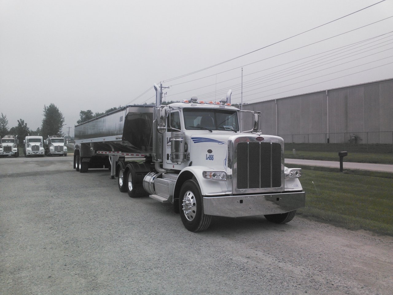

    Started buying the USPs in model year 2016 trucks. Some have a little over 400,000 on them now. We are pretty weight sensitive so we run 10 speeds in tractors. They replaced FRO16210c equipped tractors. Early model was a FO-16E310C-VAS, but later ones are the LAS. Only difference I see is VAS doesn't skip gears and the LAS doesn't have a pump support bracket on transmission. We run T880 in pneumatic division and 389 in end dump division. Have to say I like the Cobra shifters better in T880 vs pushbutton in 389. NCM_0110.JPG
    You can see a T880 in back. 389 definitely looks better!
