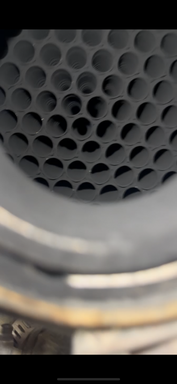

    I actually had the pipes apart to clean them. Didn’t remove the cooler but did get a look at it
  7. Brandon0928
    Brandon0928 Light Load Member
    184
    105
    May 14, 2022
    What it looked like today
  8. ducnut
    ducnut Road Train Member
    2,570
    7,732
    Dec 31, 2010
    SPI
    What’s in your oil fill cap is normal.
