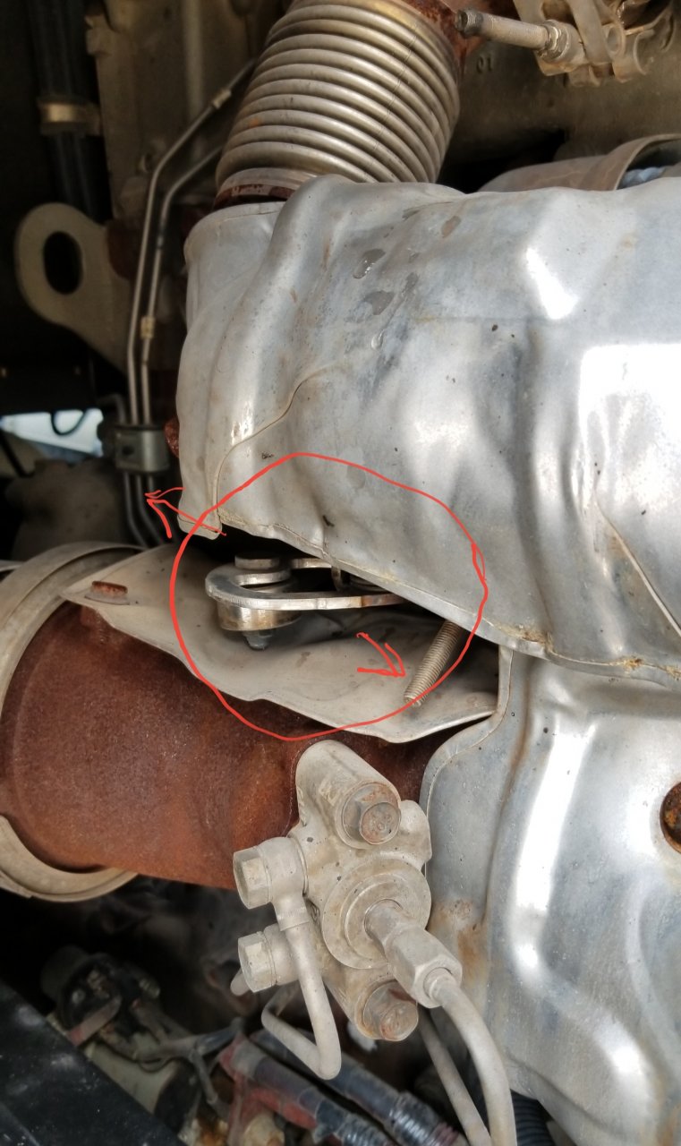

    This thingy is dancing back and forth while idling. Dont know what it is but I know it ain't right. Called my LA mechanic, and he says it means the fuel pump is going bad, another $2000.

    about pic# 2. $900 repair if it is egr actuator malfunctioning
