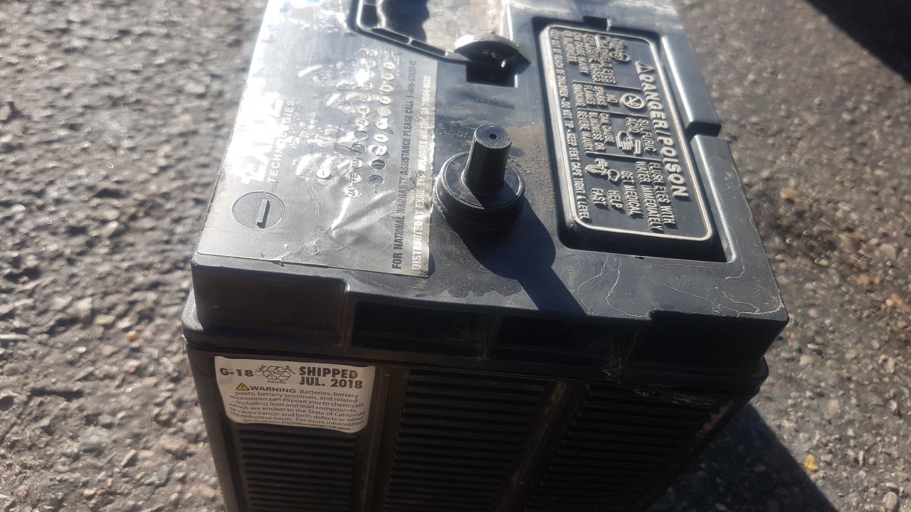

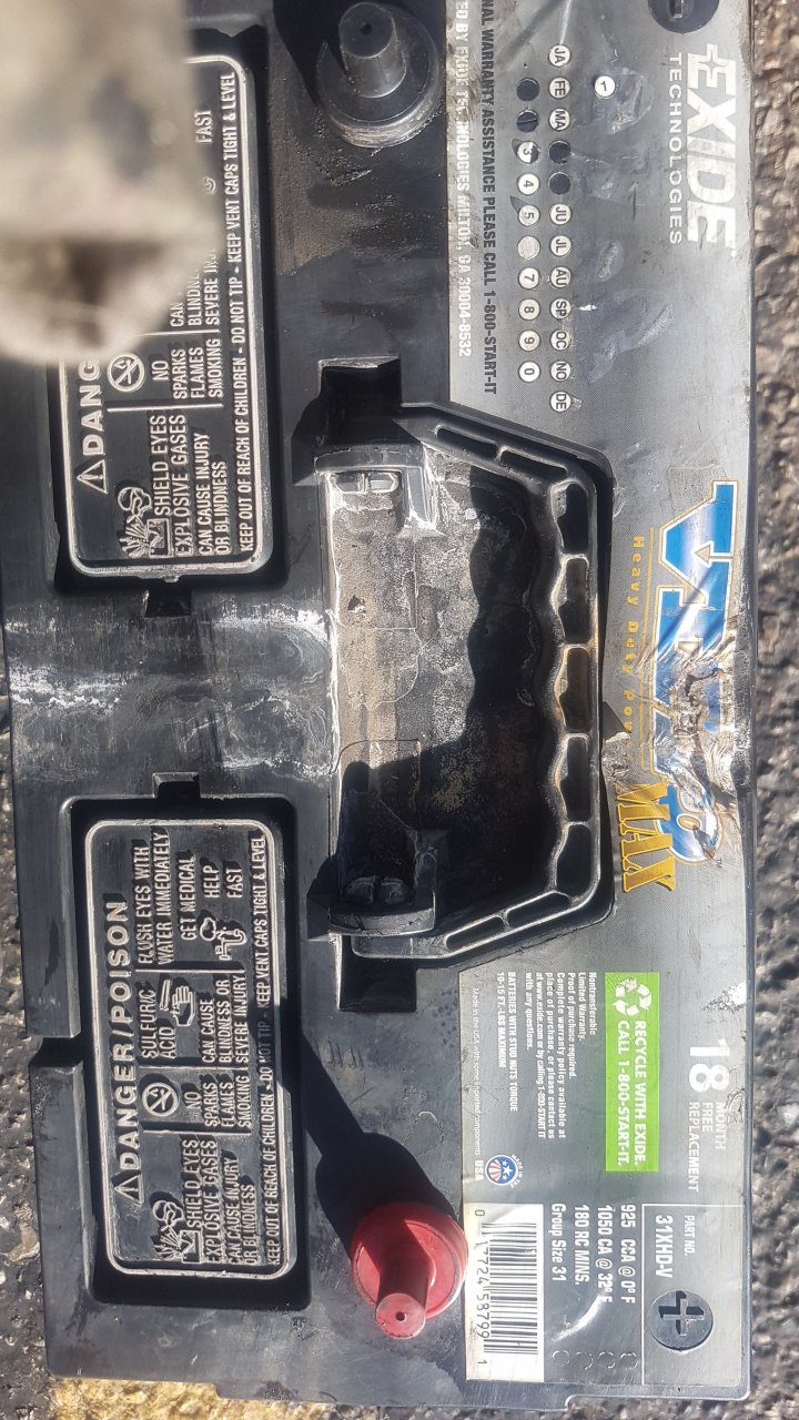

    I stopped at freightliner and purchased this battery. Three day ago I had purchased one exact like this at TA Lebo, KS . It was little expansive than 950CCA starting battery($85). As soon as I get home I will buy 2 more same as this one ... 2.jpg 1.jpg 5.jpg

    That's from over charging. When you overcharge your batteries they swell up like that. Check your charging volts. Much more than 14.1 v will do that over time. Could be voltage regulator, wiring or alternator. My volt meter in the cab reads 14.6 to 14.7 and all my batteries looked like that when I replaced them.
  5. mhyn
    mhyn Road Train Member
    4,255
    4,513
    Dec 29, 2008
    Northridge, CA
    I was thinking like you. Not overcharging issue. the batteries had short inside...
