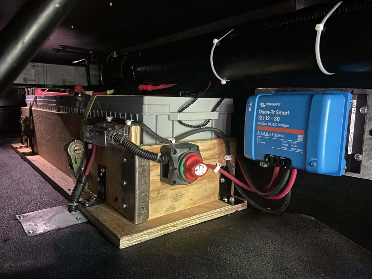

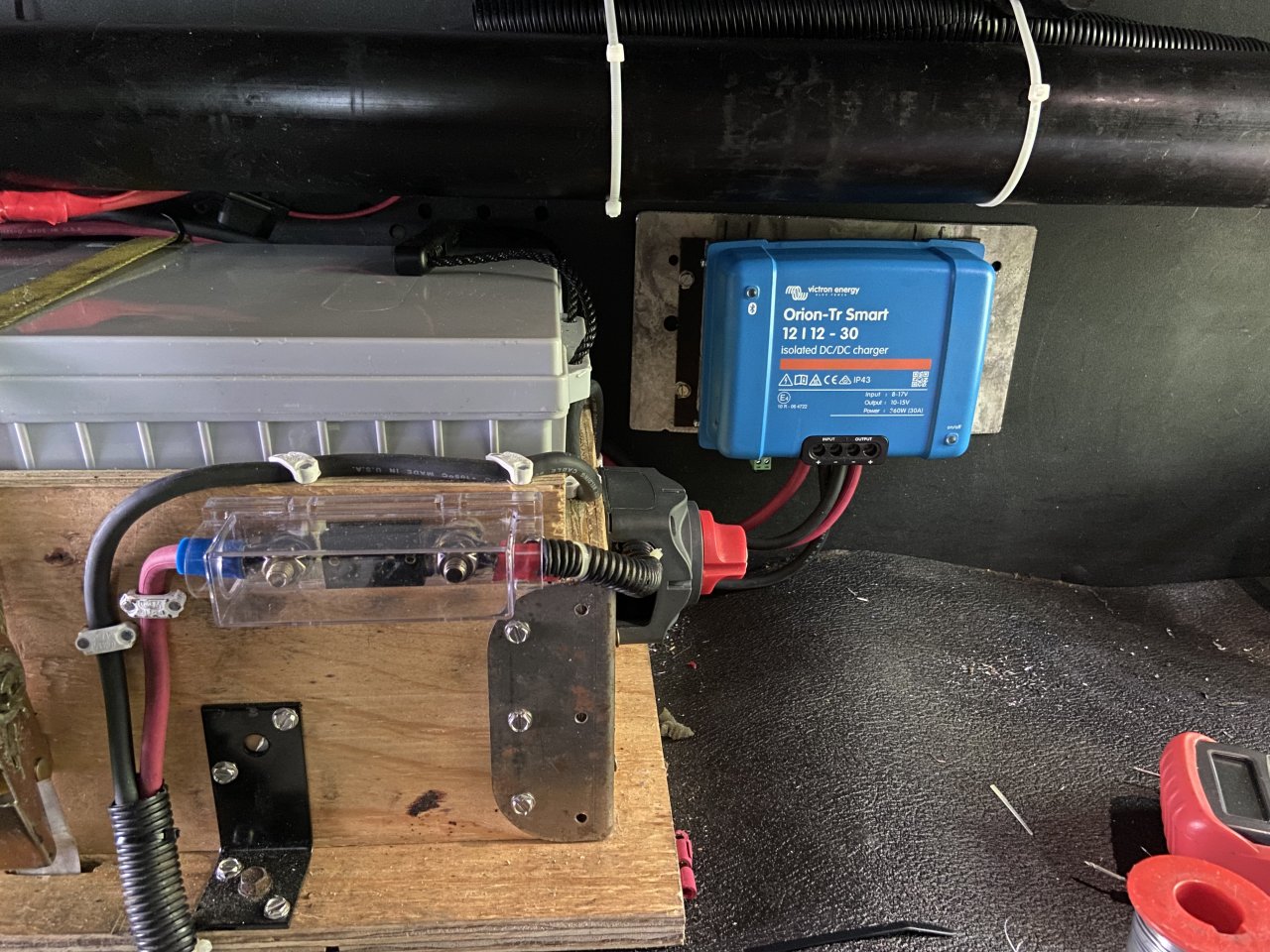

    I was told to consider adding rooftop solar to improve battery charging. The sales guy said it may cut charging time up to 20%. I may still add solar if the recharge time averages 8 hours instead of 5. Since I don’t use the AC in the winter months I could hook up my inverter to the auxiliary batteries to run my Microwave and TV. I don’t use either one much but it would take some load off the house batteries.

    Even if you don't do solar, look to those guys for ideas on power management and parts. The ones that run separate house batteries are buying the LiFePO (Lithium Iron Phosphate) batteries. 1/2 the weight of lead/acid, you can discharge them all the way to zero without harm, and they hold adequate voltage right up to the end. They just aren't suitable for starting, so not good for an all-in-one plan. And kind of expensive, but they are becoming more affordable.
    I'm running a mini-split on mine and see similar charge times after an overnight. However, daytime use is not ideal. I haul a reefer, so that's needed. I'm using the truck batteries, but have swapped in a set of Northstar hybrid AGM batteries good for about 25% more capacity over the standard AGM's the truck came with. I've got 480W of solar to go on the roof, just not enough time to get it done yet. My goal is to offset heavier demand during the daytime, to preserve more capacity for running the a/c overnight. Also, the solar panels will charge all day even with the truck running. So will supplement the factory 135A alternator and likely reduce recharge time when driving in daylight. I've considered building or buying a beefier alternator, but going to see how well the solar performs before doing that.
    ETA: Nice job on the insulation. I don't know what I was thinking, not going to home depot for some of that when I had my back wall peeled out for the mini install. May not have been complete, but you're not kidding about the pretend insulation used by the factory.

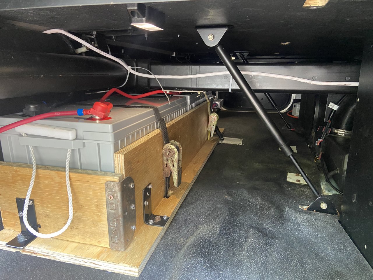

    At $3400 minimum for just the Lithium batteries I had to pass. I already had $3K into this without batteries so I figured I can always add them later if the AGM doesn’t work out or I use them up in a year or two. Plus the AGM’s are sealed so I can put them inside. That saved another $500 buying a frame mounted box.
    I do think solar will help, especially on days where you don’t get enough drive time to fully recharge with the alternator.

    Well…. That didn’t take long. My alternator went out. That answers the question if a 160 amp will hold up. I found a 200 amp locally and put it in today. I am now looking for a 300 amp.
