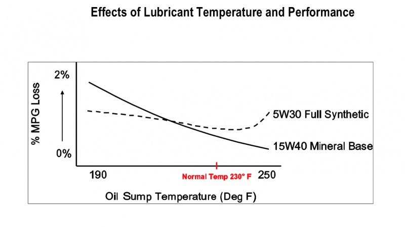

    "Up to" 2% -- which means when cold. From the Cummins white paper:
