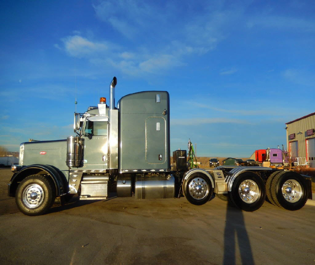

    Im looking at a short hood 389 with a 63in bunk with current spread of 190,63,54 for a 280" wb with a 9'9 spread. If I can get my drunk squirrels to sober up and line up for a spring time purchase Im looking at them changing it to a 180,99,54 which will put me at 306 with a 12'9 spread.
  9. Pnwtrucker
    Pnwtrucker Medium Load Member
    383
    821
    Nov 5, 2016
    That'll be a nice setup.
  10. Roberts450
    Roberts450 Road Train Member
    2,237
    3,636
    Feb 6, 2016
    Yea. 2015 with 99,000 on the clock. Only a 13.2 front end but sittin on 385/75/22.5's heavy 40 rears with 3.55's but would need to change from 11r24.5 to 11r22.5 to lower the 5th wheel and its a 550/1850 ISX with and 18sp.

    That's a sharp looking ride. That be great maxi truck
