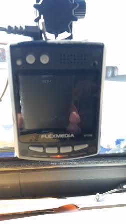

    I use the DB4 from Dieselboss since 2 years now. It runs 24/7 and I only stop it when I need to download some footage. The quality is only 720p wich is acceptable.
    I stopped the sound because there is a rattling noise coming from the plastics holder or somewhere, and I can't stand that while I watch the footage. The loud rattling noise is the only issue I ever had with and it is not from the camera but rather from the windshield holder.
    The camera is absolutely reliable and for 80$ is a no brainer.
