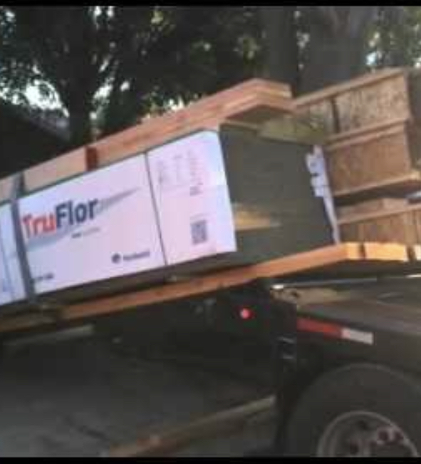

    As soon as i saw your picture........................i knew that the one buying the trucks puts effort in it.
