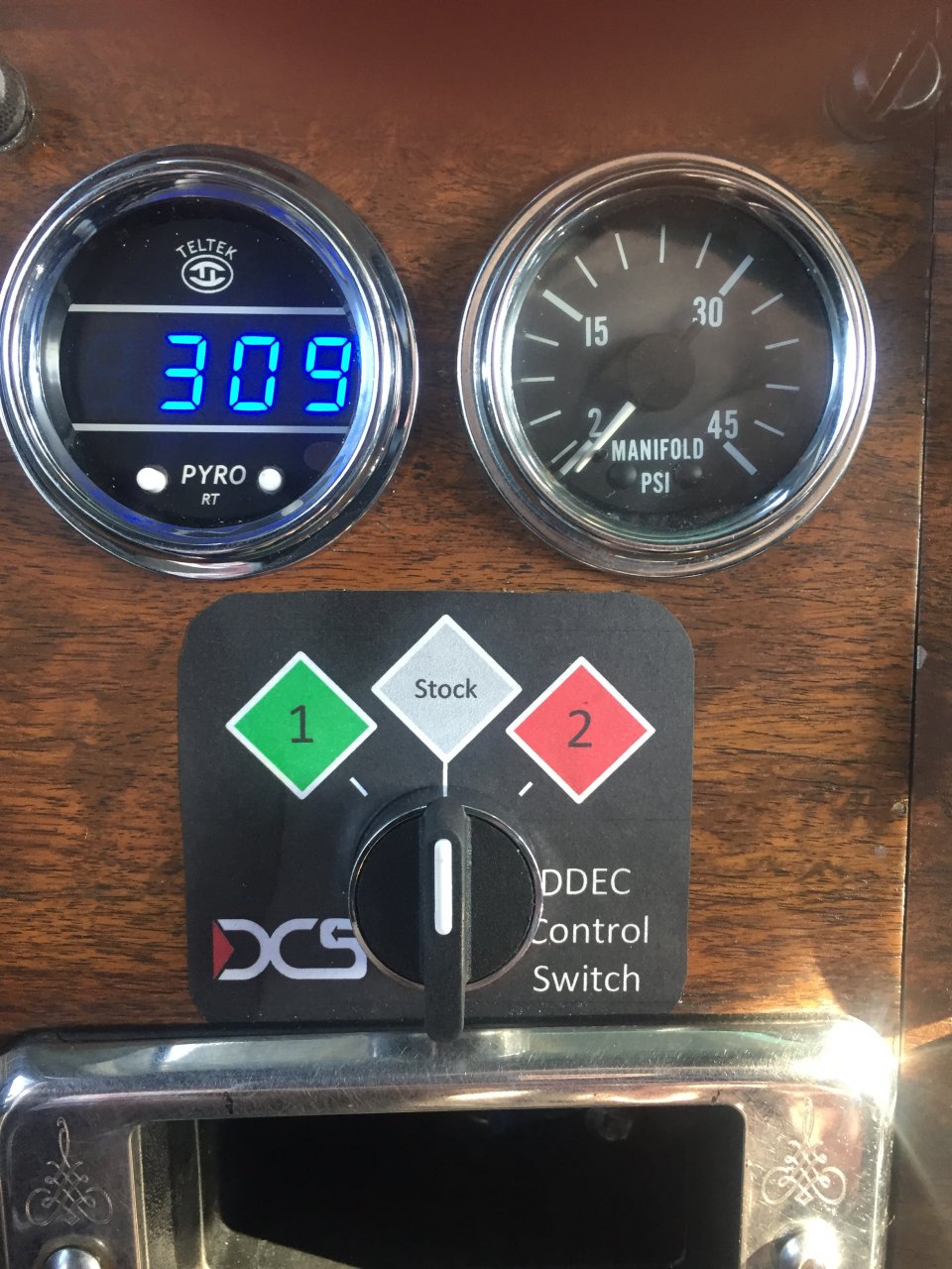

    I have a 12.7 with a triple play from Diesel Control Service. 500, 600 or 700 HP at the turn of a switch. He can set it any way you want.
    Now if you want a real horse find a 1693 Cat, the last real motor that cat made.
    7-UP Thanks this.
